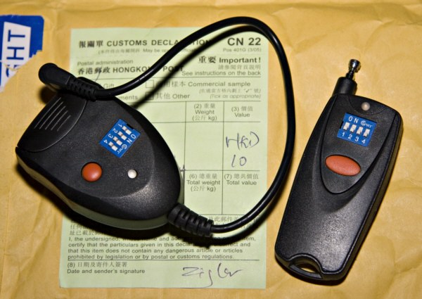

Wireless remote for Canon cameras (fits models - EOS 350D/Rebel xT, EOS 300D/Rebel, EOS 400D/Rebel xTi, EOS 30,33, EOS 50,50E, EOS 300V, 300)

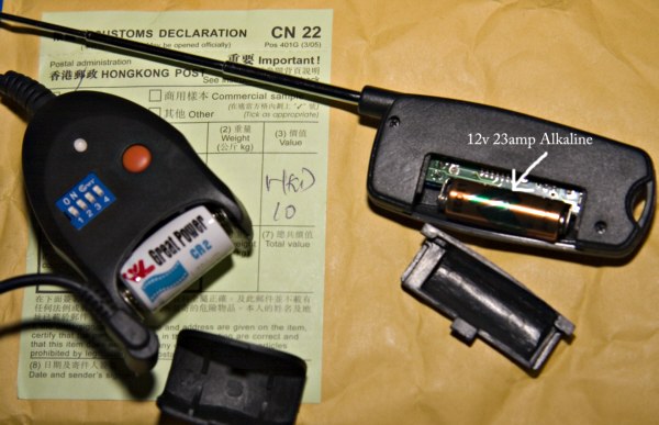

Both units are about 5cm/2inches in length. The receiver unit (Rx later on) on the left uses a CR-2 lithium battery, important point here, the CR-2 comes with a tight plastic wrapping that you must remove to allow it to make contact (took me 5 minutes to figure that one out when the receiver would not switch on at first) To switch it on you press and hold the red button for 2-3 seconds until the led lights up red and flashes rapidly for a second or so, then it will flash on/off slowly after that.

The transmitter (Tx) uses a 12 volt 23amp Alkaline battery marked L1028 on mine, I think it's the same one used in some car remote controls. This battery has no covering so will work fine from the off. The transmitter does not switch on as such but works by pressing down on the red button. A half press will focus the camera and a full press takes the shot just as with the shutter button on the camera itself. It also has an extending aerial, I assume you need to pull it out fully to get the best out of the unit.

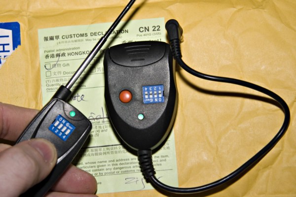

Once you have the Rx plugged in and switched on, a half press on the Tx button turns turns the LEDs on both units Green, a full press turns both LEDs red and takes the shot. Long timed exposures are taken by setting the camera to bulb, then the first full press on the Tx opens the shutter and the second closes it, easy.
There's a set of 4 dip switches on both units, you set the switches on the Tx to match those on the Rx, this arrangement means you can have up to 16 cameras with RX working independently from one Tx, not much use for 16 I don't think but 2 or possibly 3 maybe.
Build quality is fine, both units seem sturdy and well made. So far I'm very pleased with this purchase, I'll need to do some long distance tests to check the claimed 10-20 meter range but for now the remote set does what it was advertised to do at less than the cost of the basic Canon remote and there's no cable trailing.
