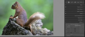

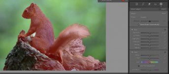

I always denoise an image first if needed in DXO and up until couple days ago worked great but now when I re-import as DNG to Lightroom Classic I cannot get any selection of Object, Sky or Background, works fine on a RAW image 1st image RAW as can be seen selected object

It's a known issue. The process version is being change to version 1 which predated all these extra tools.
Open the calibration tab and select the latest process version.
