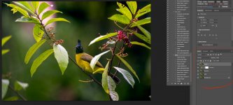

Thanks for all the feedback and tips. Last night I had a good old chinwag to myself and came up with this.
Right click on image in Lightroom classic > Edit in PS
Run this action that I created last night for my bird/wildlife images
Before
After
The whole process of the action running took less than 20 seconds, and because all the actions are in individual layers they can easily be tweaked as required.......pretty chuffed with myself

I was looking for a short cut to ACR and now I have one click to photoshop followed by an action which includes ACR in the first step………… Perfect
