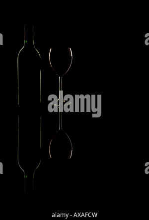

Use a large softbox with a strip of black card centraly against the front screen. Leave room for light to escape at the sides. Put glass/bottle in front of black card, use reflectors to bounce light back if needed. Photoshop as required to fill remaining black. As done here:
