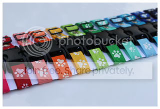

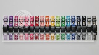

Two older pictures but gives an idea of what I'm trying to photograph, I would like the background colour to be consistent and a get a true colour of the products.
Those dog collars could be lit much better. The light is much too far away and is pointing straight down.

Be aware though that the background will not photograph as white, when arranged as in your sample pics.
You would need to place the products on a sheet of glass, have the background a few feet below the glass and light the background separately, with at least one other flash head. Even so, care is needed to get the background pure white but without overexposing it to the point where it reduces image contrast and eats away at the edges of the subject. A more professional way of doing it is to photograph it on a white paper background and cut it out on computer, a quick and easy job.
If you're not going to cut them out from the background then get a paper background. Vinyl is an option and it wipes clean, doesn't get creased etc but the texture will show in closeup shots.
