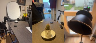

Anyway, my subject here is a cactus, a friend gave it to me and said something about it being hard and prickly on the outside and soft on the inside, just like me, but I have no idea what he was talking about
As always, the first decision is about the effect we want to achieve. We then arrange the set – once again I used my ubiquitous bit of white shiny plastic (but didn’t bother to clean off all the bits of earth). It may not look very white, that’s because very little light reached it.
Having arranged the subject, we then arrange the camera position and stick it on a tripod. The position of the light is dependent on the camera position and angle, so the light positioning is always the last thing we do.
In my example, the light was placed a long way from the subject, at a distance of about 9 feet. The reason for this was that as distance increases, the effect of the Inverse Square law reduces, so if the light is too close the fall-off of light will be too rapid.
Here we are, with just the honeycomb
As you can see, the honeycombed light has really emphasised the texture, but has left us with one side that’s totally unlit.
So, I added a reflector, as close as possible and only just out of shot
The reflector was another bit of white plastic, supported by a slightly-opened book, but could have been paper, card, a mirror, cooking foil or anything else that worked. And, because the light was so far away, the reflector has balanced the light pretty well. I could have moved the reflector a bit closer to get slightly more lighting balance, it’s all about what you want to achieve.
What else could I have done?
Well, I could have changed the reflector angle a bit, and bounced some of the reflected light on to a second reflector, but that’s a complicated way of doing things, and the reality is that it’s easier and better to add an on-axis weak fill light if we want to, but the terms of these challenges limit us to using just a single light.
The setup shot below shows how this would be done

My turn, hope I've got this right.
First is BTS Shot.
So, above, L->R is from the flash viewpoint, from the reflector viewpoint then the bowens s mount type reflector and dish. Bought that off amazon the other day for about 18 quid.
Reflector was then handheld about 12-18 inches from the cactus, flash / honeycomb here is just 7 foot away opposite so trying to shoot directly from the side perpendicular to where the camera is shooting.
So also you may see I had to employ the black of the folded softbox behind too as there's a lot of reflective surfaces in the dining room including a silver coffee machine so I shot this very tightly so I've not even cropped this shot, it's literally all in camera.
First shot without reflector
Challenge3a by Donnie Canning, on Flickr
Then with the reflector to bring some light onto the dark side.
Challenge3b by Donnie Canning, on Flickr
My main thing about this shot is the fact that its quite a small cactus and Im aware that the smoothness and brightness of the cup/saucer may be counter to the spikeness of the cactus.
