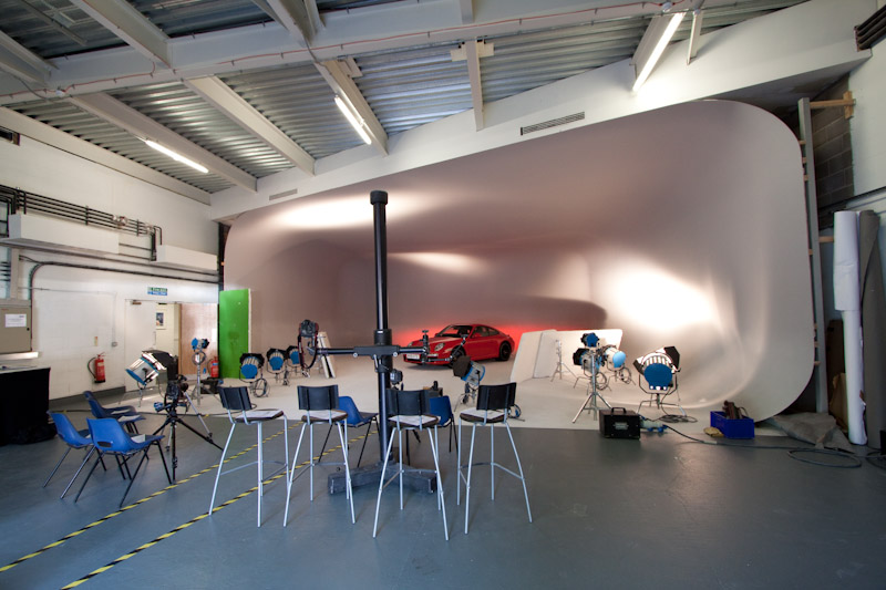

Magazine shots use a proper studio with a large infinity wall, then bounce the light off the walls, with small lights to pick out details like the wheels. It did take about an hour to set up the lighting right though and these are 3kw, 2kw and 500w lights so it gets warm.

Those photos will be very helpful to the OP - or to anyone who wants to do a pro job, and it's a valid method.

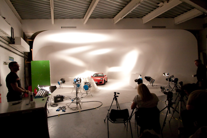

This is probably way over the top for what Me2 was asking, but shows the techniques used in the big studios. The ideas the same, just needs to be scaled back and portable, however do look at Tim Wallaces work. He's know for shooting high end cars and is a details person. Look at the way he picks out details of the car.

I've chaperoned a number of expensive cars to studio shoots for magazines and books. In the pre-digital age they would re-painted the floor after moving the car into position / jacking up each corner and ensuring wheel centre cap was correctly aligned. It was just white trade emulsion but the cost of paint was cheaper than retouching. Go-jack skates were essential bits of kit too.
That's Haymarkets studio at Teddington Lock. The floor is repainted last thing so it dries overnight
