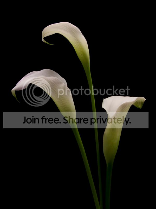

Here's one of my first efforts at shooting against black. A bit of PP to adjust the black clipping point was all I needed to make the background vanish entirely. Shooting in raw made WB adjustment a piece of cake too.

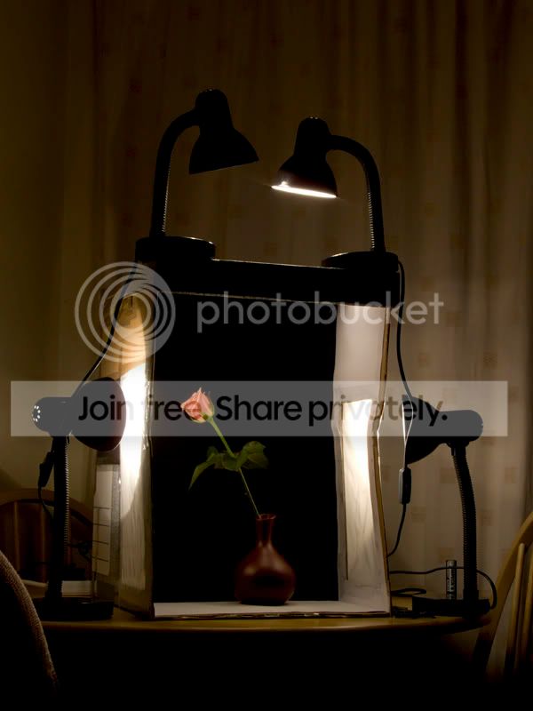

I use 4 lamps to give a more even coverage of lighting, (two from above, one from the left and one from the right). The other benefit from this is that you can, with more light, shoot at faster shutter speeds which helps with the black background.
Also shoot in RAW to change the light balance as required.
Example:
Set up:
