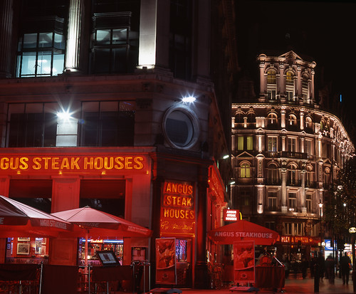

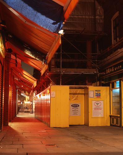

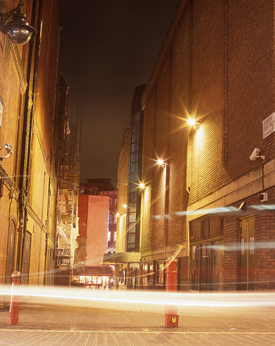

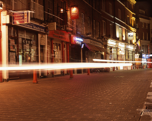

EdinburghGary wanted some dark slide scans, and I haven't been doing nearly as much scanning as I should have.
Here's a series of shots I took using the RZ67, 110mm f/2.8 and Provia 100F a few months ago. I seem to remember most of the exposures being 30 seconds+. They're probably shot around f/16 or f/22.
They're all straight out of the V700, partially for Gary's benefit. They've had mild sharpening, but nothing else.

Blapto,
Thanks so much for taking the time. Can I ask what difficulties you encoutered with the scan (if any), and generally what steps you took. What software did you use, the Epson stuff? Or was it the other bundled PRO software? Did you use the Anti Dust and Scratch System (ice?). What about the "multi scan", almost HDR type technique to get the full dynamic range?
Gary.
For these, it was Epson Scan, 4800 dpi, 48 bit colour, no multi scan/HDR/ICE magic, big green button GO!
On closer inspection of the negative, 5 is a poor scan, I'll re-do it tomorrow.
Well you have instilled a lot of confidence in me! I was worried about shadow retention of details, and these photos are perfect test subjects.
