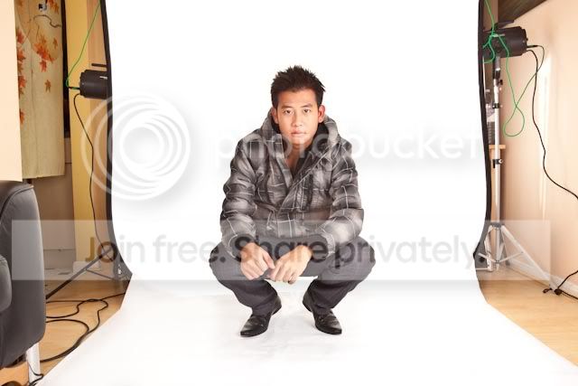

I use 2 x Courtney studio flash heads to light the hi-lite using slave to trigger them from a pair of Elinchrom 200's with softboxes... The Courtney's go either side of the hi-lite, and the Elinchrom's can go wherever you like depending on how you want your subject lit...
Here's an uncropped one from yesterday - showing that it just fits in my narrow lounge :) Oh and I forgot to zip up the right hand side - as you can see the light bleed onto the wall....

The image above is un-photoshopped - and you can see the join for sure - but it's not immensely obvious. If I had a fifth light I'd light the rear of the train separately, but at the moment I only have 4....
