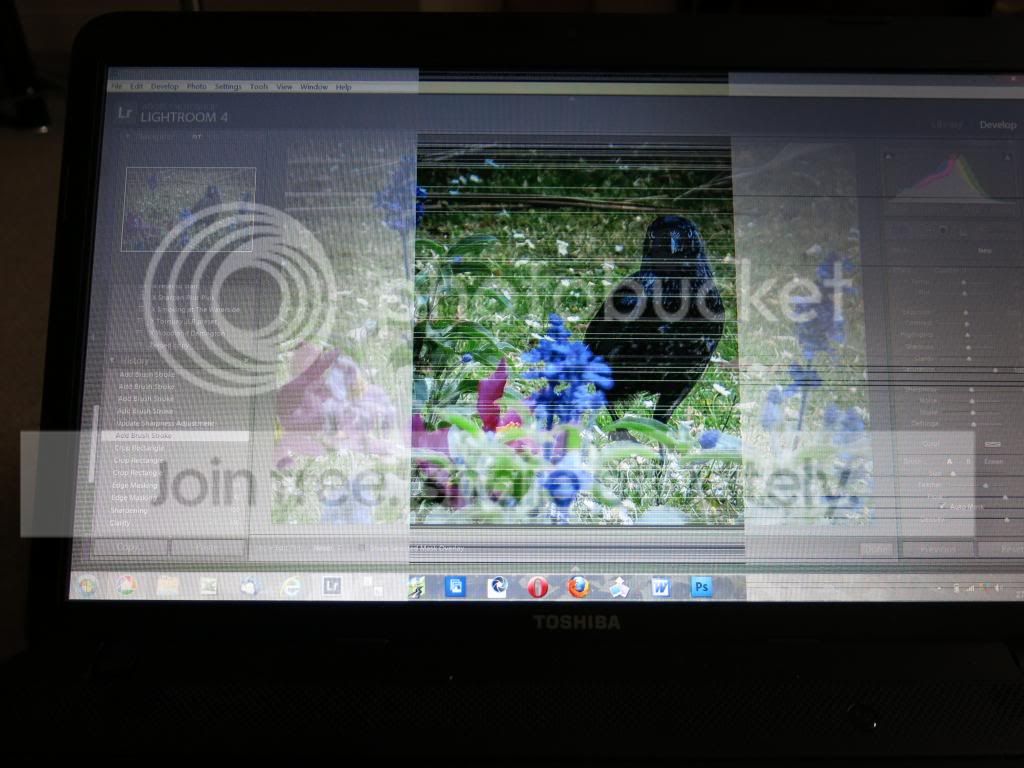

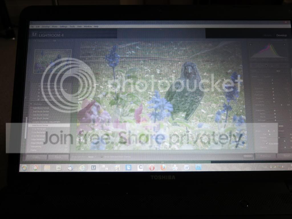

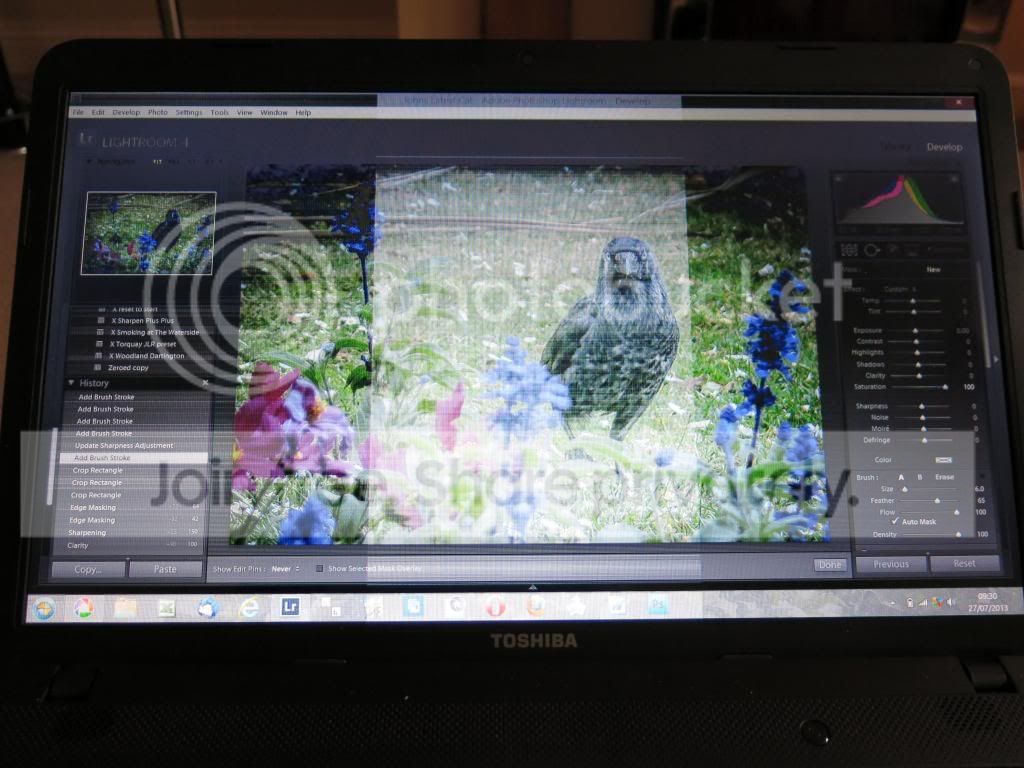

I have a six month old Toshiba laptop & in the past few days it is worrying me.
Each time I start up the screen has - like - interference lines running across it. What does this mean - I wonder :thinking:
Rang Toshiba support who said 98% certain to be software issue NOT hardware & suggested system recovery back to how it was when first bought :thinking:
I think I will run the usual CC & Malware stuff to see what I can do as 'back to factory' thing will be a right pain.
Any ideas anyone :help:
Do they go away or change when you move the hinge (not good)
Three shots taken when just started up.

Yeah try updating your graphics driver.
If not, it looks to me like a hardware fault in my opinion.

Hook up to a monitor, enter bios/system setup (f2 or Del) on toshiba screeb and if it still does it, then its a hardware fault. could be a dodgy graphics card chip or laptop screen is playing up
At this stage you need to stop investigating and ask for replace or refund on a six month old machine.

What your seeing are one of two things:
1) The connection to the screen is worn, common in cheap laptops as the cable work hardens with the constant open/close of the screen.
Test this by closing the screen and seeing if the lines move/change at all.
2) Graphics artefacts from a heat damaged GPU.
Nothing you can do.

My Laptop went back for repair - to Germany - and was a total of eight days with full order tracking at all stages. It came back yesterday so I now have the task of getting my things back on it but I have a checklist which I prepared before it went off :clap:
It's had a new screen, BIOS & DMI checked & tested with T&D but not sure what the latter means :thinking:
