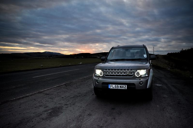

Hey, I'm really struggling with landscapes lately, I can either focus on the ground of the sky not both so when getting the ground focused and metered correctly the Sky is completely blown out.
This is the best I've done recently, but edited a lot in Lightroom to bring out the sky detail.
Any tips are appreciated!
