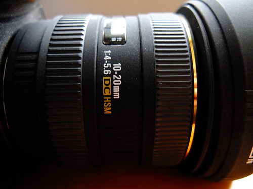

Collected the Siggy today, just need to sauce a big stopper. I think Teamwork have a couple left, so I best put an order in... Thanks for your help guys :thumbs:
Sigma 10-20MM by hpygolucky, on Flickr

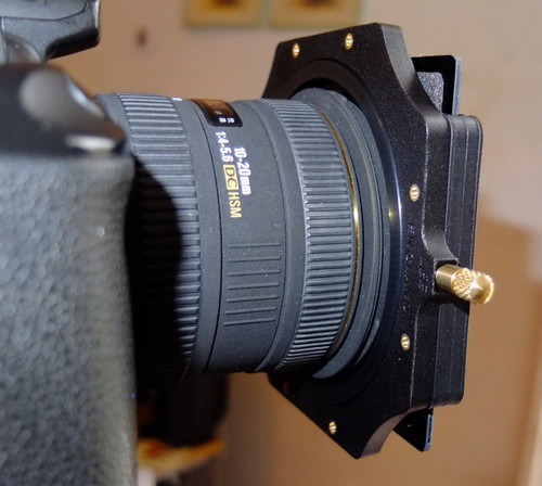

I love my 10-20 - am just doing the same thing as you. Wide angle adapter bought and foundation kit bought.
Now it's just the filters to upgrade..

Personally my expereince is that a wideangle adaptor isnt really needed with the 100mm system unless you add in more than 2 slots or a polarizer ring.
I'v used my 2 slot Lee holder with a Canon 10-22mm and to my supprize a Nikon 16-35mm on FF with a standard 77mm adaptor ring without any trouble.

you can also use a hacksaw blade to cut the outer two slots off a standard holder to avoid vignetting
