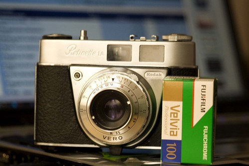

Hello to the the film & conventional forum! Not somewhere I've spent a great deal of time as yet, but that's hopefully about to change!
I've decided to put some film through an old camera (I think it's from 1959?) and after doing a bit of reading on here I chose Fujifilm Velvia 200. But they didn't have that in my local Jessops so I ended up with a 36exp roll of Velvia100. For £9.00! God, I didn't realise film was that much! Anyway, I digress.

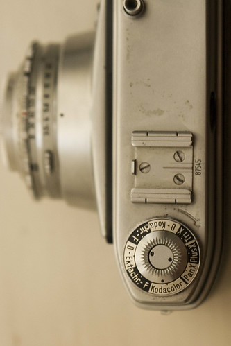

My problem is this:
On the camera instead of ASA/ISO numbers it has types of film listed:
I can set the film speed pretty much anywhere in this circle and any variant in between.
So where should I set the film speed selector then?
Many thanks,
Pip
You don't need to set it at all It is simply a reminder of the film you have loaded it does nothing else.
The camera does not have an exposure meter built in you must either estimate the exposure or use a hand held exposure meter.

Nice camera! :thumbs:
There's no metering in the camera, that dial is just a reminder to yourself of what film type you have in there- it isn't connected to anything within the camera.. I wouldn't bother setting it at all. All you need to remember is the ISO rating of the film you have loaded. If you're using a separate meter just set that ISO on the meter. :)
Oh I see, I'm gonna have to dig out one of the old light meters as well then! Or get good at estimating... Thanks Terry!

Would I be better of using the Retinette or do you think I may be better off with an old Voigtlander Vito C?
Thanks
Pip
It depends which lens and shutter each has fitted they both came with a range from reasonable to excellent.
The Retinas usually had lenses from the Schneider and Zeiss ranges whilst Voigtlander made their own lenses, many of which were excellent.
Cameras from both ranges sold in England mostly with the less expensive lenses.
