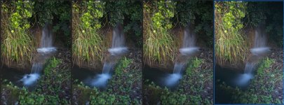

An obvious use for such a filter to a photographer is to create ‘silky water’ using a longer exposure, so my first stop was at a small local waterfall. In order to get a feel for the filter performance, with the filter fitted and on minimum. ISO was adjusted fixed at 100 and adjustments made from minimum to maximum, giving exposures at 0.15, 0.7sec, 4.0 and 20sec. There was no photo without the filter because the waterfall is enclosed and access to the camera and lens to remove the filter risked dropping it.
At the time of taking, only the maximum effect gave obvious dark corners, but on review the images, it was clear that the adjustment for the 4.0 second exposure also has slightly darkened corners, although they were much less obvious. The image that received a 20 second exposure showed a brighter centre and darker corners due to the interference pattern. There was no obvious loss of sharpness at the different settings.
Waterfall comparison: Minimum 0.17, 0.7, 4, 20 seconds maximum (showing dark corners)
100% closeup centre.

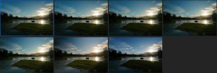

Direct into the sun
Basic settings were 24mm (widest setting) f8, ISO fixed at 100. Starting at minimum density, the filter was turned 3 spots at a time, however for the final exposure the filter had reached the point of interference, causing the darkened corners again. 4 frames were shot using the filter, with exposures 1/750, 1/250/, 1/90, 1/8, and after the filter was removed a final exposure at 1/2000.
These images were slightly post-processed and received the same (manual) adjustment. The sun was close to the centre of the image and flare with the filter shooting directly into the sun is strong, with green spots above and purple below the light source, plus a visible bright circular halo. In the shot without the filter there are signs of slight haloing, but they are mild and easily fixed in post.
Filter minimum 1/750, 1/250, 1/90, 1/18 maximum. 1/2000 without filter.
24mm f8, 1/250. With filter near minimum.
Without filter 1/2000
A second series of images were shot with the sun nearer to the edge of the image. These showed much less flare, and also less warming except at the setting of greatest density.
24mm f8. Filter minimum 1/250, 1/200, 1/160, 1/80, 1/25, 1/13 maximum. 1/800 without filter.
