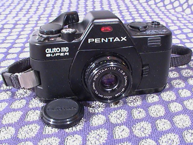

Personally I would love it if someone would start making 110 film again, Kodak stopped a couple of years ago and only out of date stock is available. Although I am seriously considering making a film slitter and making some then loading it into an old 110 cartidge, theres plenty of old Kodak stock on ebay to nick the cartridges off. I've always wanted to try one of those little Pentax Auto 110s that are so small that one journalist used to hide one in his shoe when going to concerts, stand up commedy etc to get it past security and get the pictures published before anyone else.

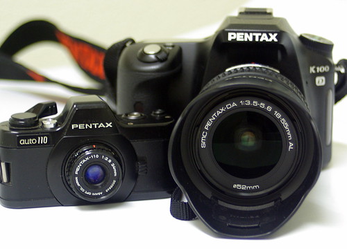

The difficulty though is that you need cartridges, which are getting scarce as the last remaining Kodak and Fuji 110 stocks are getting used up. But hey if you can still get frozen disc film then I bet you'll still be able to get 110 in a few years. The other main problem is that there were only two film speeds with 110, 80/100 (depending on the camera) and 400. The camera reads whether a notch on the cartridge is there or not so you also need a cartridge with the correct notch. As I said I would love to do this and use one of those little Pentax Auto 110 SLR's.
Look at it compared to the size of a Pentax K100d SLR
