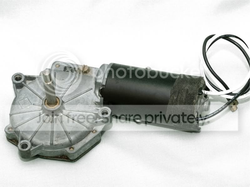

I've got a Jobo motor you can have if you want to PM your address. I think it runs off a 12-18 volt DC supply. You would need to mount it in some sort of watertight box with the shaft poking out.
I bought the motor to make a gem stone grinder for my daughter and never got around to making it.

If you do Ed, can you take a couple of pictures and give me any serial or part numbers that are on it please? There is a rumour that it is a BMW wiper motor, mine's not working but I've not had chance to get at it and open it up yet.
Will do.

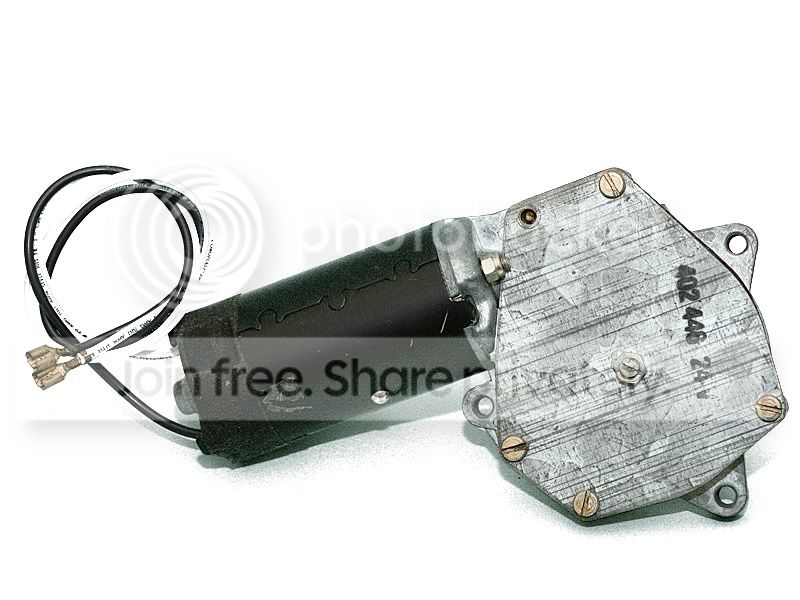

Found it.
On one side of the housing there is some raised writing says SWF GERMANY.
Printed on the flange that side is R63
Printed on the rear is 402 448 24V
Pictures to follow, I will post it out on Monday.
Thanks Ed and everyone else.
Looking forward to having a mess.

I'll know as soon as I get mine apart, I was an autoelectrician in a former life for my sins. :)
Here Tis'
Well it's like a wiper motor but it's not got any park switches or anything in it, the shaft is a bit oddball too. Thanks for that.
Ed, would you mind if I posted your pics on APUG so they can have a look and someone may know what sort of motor it is?
Which Jobo is it from?
Well they are hardly going to be award winners, :lol: so help yourself :thumbs:
To be honest I can't remember, but I suspect it was the CPP rather than the CPE2.
Oh, the white cable is actually green, when I took out the Chromakey it took the colour out of the lead too.
