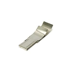

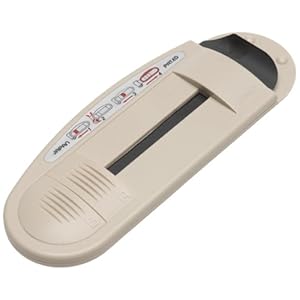

Try going into a proper camera shop and ask very nicely if they have a film retriever, it's a very thin piece of metal with little hooks on it that engage with the sprocket holes, they may even do for you!
It's called a 'Leader-Extractor'...
http://www.amazon.com/Hakuba-Film-Picker-IV/dp/B00004ZCOZ
http://www.amazon.com/Adorama-Film-Leader-Retriever-35mm/dp/B00009R6Q1

If you've a Calumet or Jacobs near you, try one of them. I got one from Calumet that's the same as the second Rob showed. I've seen them in some Jessops within the last year as well.
