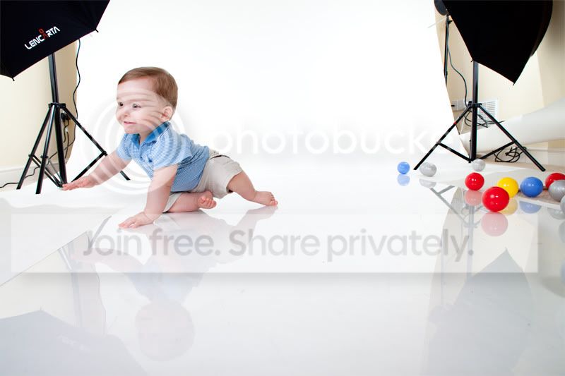

I work in my living room. It's really not big. It's so much easier if you have more space.
Here's a shot of my living room in action -
There is zero room behind me in this shot - so it's cramped but can knock oit some good images :)
Dav, you need to spread the stand legs better than that...
