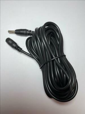

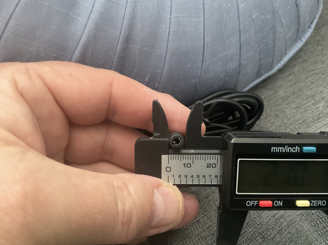

Can I get an extension this (about meters), and if so, link me please :)

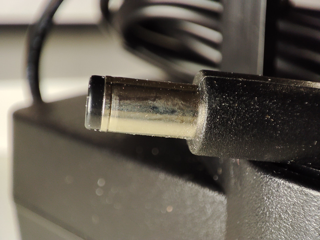

check the size of your plug, looks like 3.5mm
Yes you can get extensions but you need to know the barrel size (measured as outer diameter x inner diameter)
It looks like it could be a 5.5mm x 2.5mm which is quite a common size but your photos don’t show any kind of scale so I could be completely wrong.
5.5mm x 2.1mm is also quite common for screens and CCTV.
Just google something like 5.5mm x 2.5mm extension
It looks like it could be a 5.5mm x 2.5mm which is quite a common size but you photos done show any kind of scale so I could be completely wrong.
I’ll measure later

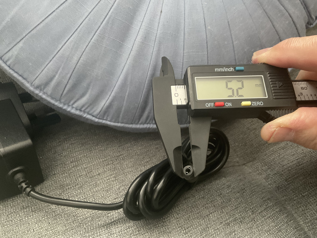

A rough guess, 10ft

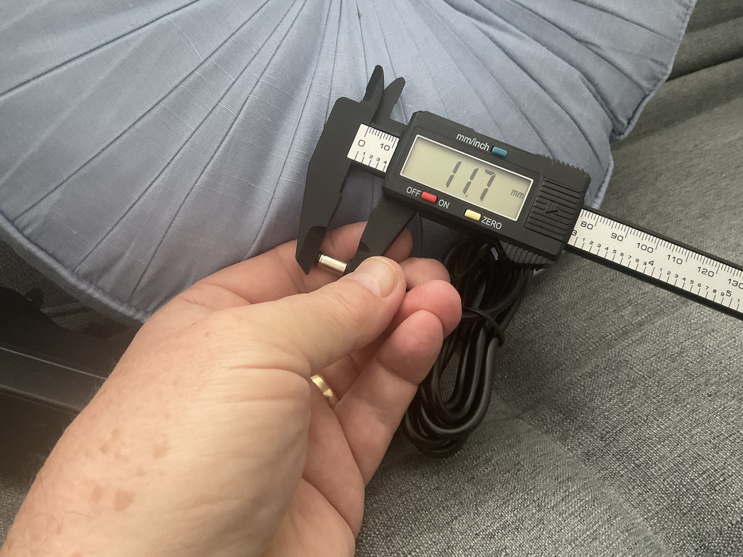

I've never seen or heard of a 5.2mm barrel so I would suspect it is 5.5mm, the other important measurement is the inner diameter ie the diameter of the hole.
The length of the barrel isn't usually needed as they are generally all the same length (approx 10-12mm)
I took one of your images into photoshop so that I could move the ruler and as suspected it looks like a 5.5mm x 2.5mm barrel

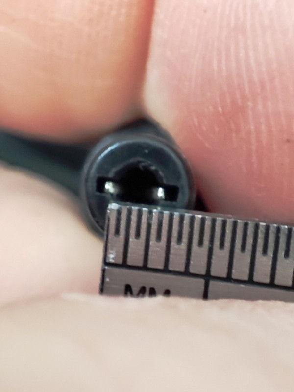

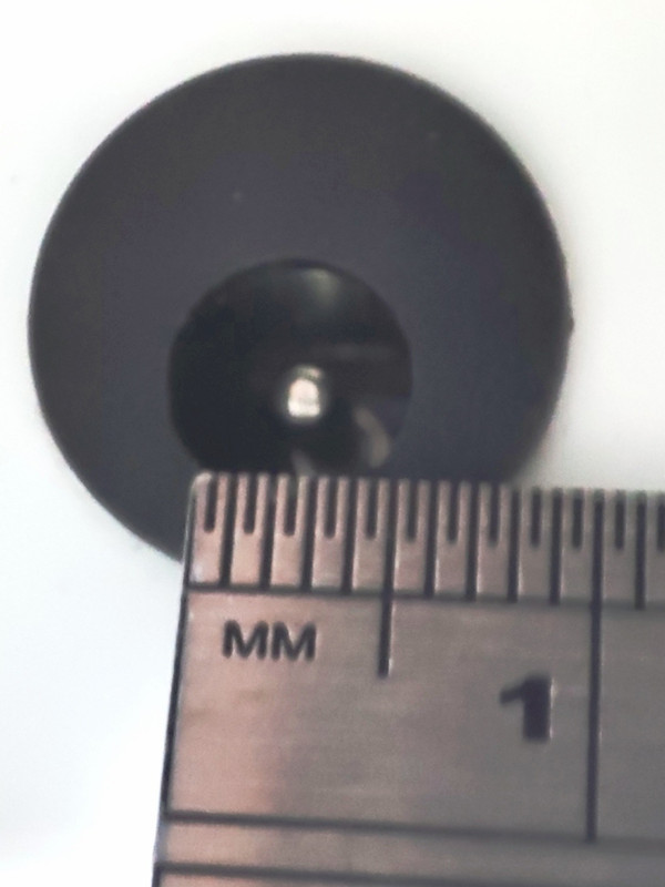

Sadly the most important part is the inner diameter - or the diameter of the pin on the mirror.
Luckily the barrel power connectors only come in 4 common sizes, some of which can be ruled out from the photos.
1.3mm (not that one by eye - they're really skinny)
2.1mm
2.5mm
3.1mm (not that one - they're usually stubbier looking)

Both inner and outer dimensions are just as important as the other.
I bought a 5.5 x 2.5mm. The male part was to big for the female part on my lead.

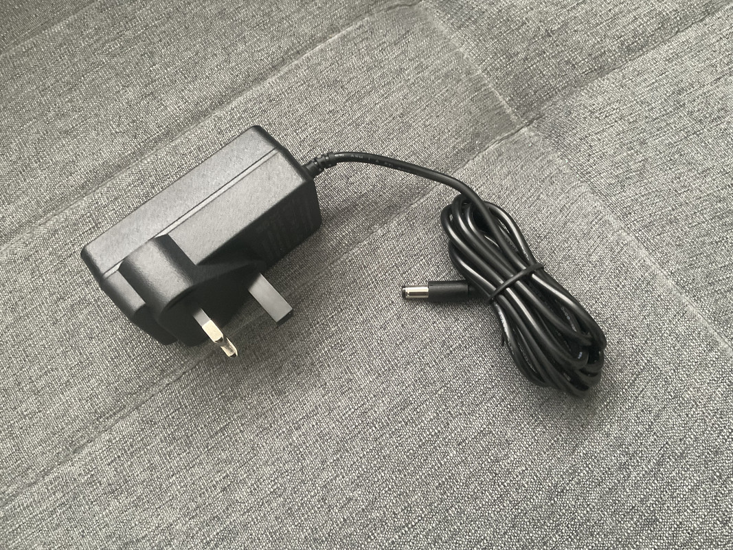

i took these. very difficult holding a ruler, plug and phone lol.
The mains lead part
what the main lead plugs into (side of a vanity mirror)
