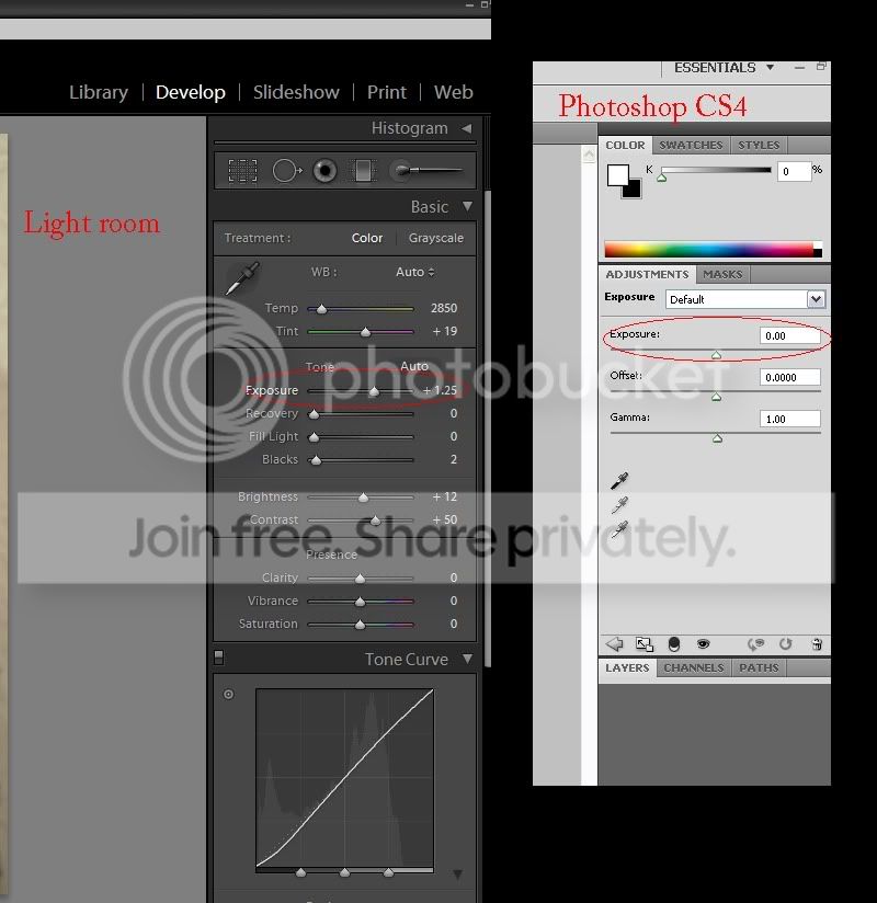

Im sure you can adjust exposure in photoshop and CS4 and also lightroom.... i think i have seen the function
**edit** Is this wha you mean? or have i got it all wrong?
Not sure if this would work for your images but its worth a try.
