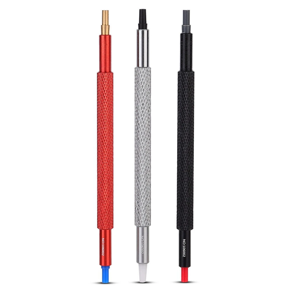

I used rodico and once the hand was in place I used a push tool. The second had was by far the most fiddly.
Yeah. Tiny bit of Rodico on a hand setting tool, then lift the second hand with that and place on the spine
Hand setting tool?
Is this like a mini press or what I called the hand push tool or something else? The hand push tool I used is just like a pen with a "nib" with a hole in it.
I just dabbed the Rodico on the hand to pick it up and placed it by hand like that. I then used the push tool to press the hand home.
Hand push tool...
Hand setting tool?
Is this like a mini press or what I called the hand push tool or something else? The hand push tool I used one the hand was in place is just like a pen with a "nib" with a hole in it.
I just dabbed the Rodico on the hand to pick it up and placed it like that.
Hand push tool...
Yes just the pen like tool with the hole in the nib
Ah.
I never thought of putting Rodico on the tool and positioning the hand like that. I missed that one :D Good idea!

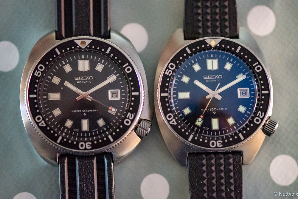

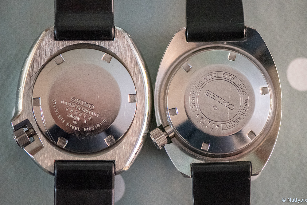

a couple of mine - but originals
6105_8110 and 6105_8009
I have quite a few old Seiko's

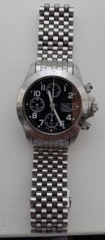

Does it function as a chronograph?
I ask because some don't. I have a two sub dial chronograph but not a three dial. I did buy one but when it arrived it was fake in two ways. Firstly it carried a famous name whilst the image on the sale page did not and secondly the sub dials did not function as they should and we're basically decoration.
That is nice Mike.
Everything functions. I hardly ever use them but they all work! :)
