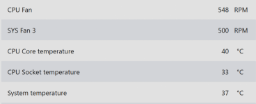

Intel engineers must be completely deaf and cold :LOL: These setups are baking hot and noisy right from the box! I've been tinkering with my 13700k ever since and brought it back down some and really wonder what is the limit in an air-cooled setup
How low or high are your temps at idle and under load?
I have so far undervolted by -.075V and that got me around minus 5-9C from the red hot sub-100C mess in Cinebench R24, and I think it could go down some more but frankly there wasn't much gains going down from -0.05V. It may be best left alone at this point?
My air cooler is middle of the road Noctua NH-U12S. Nothing special but it is listed as fully compatible.
The trouble is the temps almost instantly go there just even browsing images in LR and that brings in intolerable noise from the oh so ironically named be Quiet! and Noctua fans. Any PC noise is intolerable by definition. If I liked noise I would work in roadworks.
As the simplest and cheapest thing to do I am going to swap out the Noctua heatsink fan for Silent Wings 4 Pro 120, and limit the thing to the quietest setting, then move the removed NF-F12 as a second intake fan capped at say 6-700rpm. I really don't like the noise it makes at higher rpms. Then limit 2x case silent wings 3 front and rear fans to say 800-1000rpm. Does that sound sensible enough?
Next step would be the whole heatsink swap and that's basically NH-D15s vs Dark rock 5 pro but I'd rather not mess around and incur that cost with it if I can avoid it.
The final crazy option that I see is replacing intel bracket with Thermaltake one and adding liquid metal paste. I can't say I'm looking forward to this. It looks doable, but then it is that fragile and stupid LGA socket that just looks for reasons to die at first possible opportunity.
My understanding is any AIO setup is VERY NOISY no matter what so I'm definitely not going there.

Is this core or socket temp?
My fans are not allowed anywhere near that RPM at idle - so that is quiet if I could only keep it that way all the time.
That was Core Temperature
I have noted that there is 'CPU Package' temp and that is Idle 41c and max (records last max under load) of 53c

You know what I got so fed up I forced all case fans in Silent mode through case controller. We are talking around 35db in noisy mode but in quiet room thats unbearable. Let the bloody thing roast as high as it wants

It was a long week messing around the PC. AWD parcel finally arrived so I changed thermal paste to Arctic MX6 and I think that brought down the temps by maybe 2C to around 35-37C / 29C. It is not very scientific, doesn't account for ambient, windows background tasks, etc so it may be just a positive bias. I took the effort to spread the paste around the whole lid instead of dumping 5 dots. Tip: never ever use Arctic wipes. I had to open all windows for a whole hour to get rid of perfume stink. That definitely brought all temperatures way down :headbang:
Then I swapped Noctua NH-U12S default fan for Silent Wings 4 Pro 120mm in slowest mode and moved the NH-F12 as the second front fan capped around 5-600rpm. I also took the hammer to all fan curves in BIOS, set baseline around 5-600rpm, and brought all other points way down from default.
I have to report a positive cumulative effect in the middle section of the temperature graph. The ends pretty much remained unchanged. The good things is the fan roaring while doing any work in LR is gone, while temps remain manageable while not ideal.
So that tells us the lesson MSI BIOS pwm graphs are bats*** crazy, just bring them way down. 1C less is simply not worth suffering the noise.
Now the crazy thing is I could have bought the whole Thermalright Phantom Spirit cooler (amazon) for the price of one SW4PRO. youtube reviews suggest this is actually one of the best ever CPU air coolers for power hungry modern CPUs along with Noctua D15 but without the price tag or RAM clearance issues. The real question is if I can be bothered to reinstall the motherboard in the case to swap it out.
I may do more simple tinkering if another pair of ebay silent wings 4 140 fans actually arrive, It was too cheap not to buy when I thought I was actually done with the whole game. That;s right - my sort of computer games :LOL:

(around 41C idle and peaking at 95C under Cinebench stress test
pretty much what I was getting before undervolting at all default settings. It is hard to say if 4090 is contributing anything towards that. That's a beast of a card.
