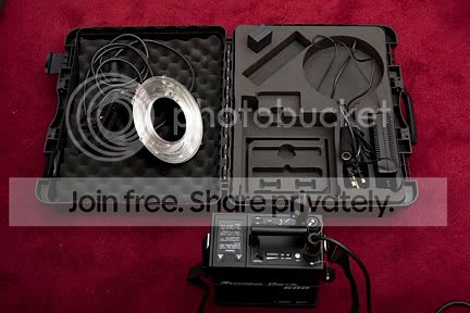

On Thursday evening I received my Lencarta Safari 600 powerpack and ringflash kit along with an additional Safari 600 powerpack head.

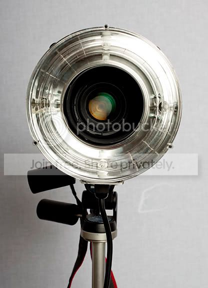

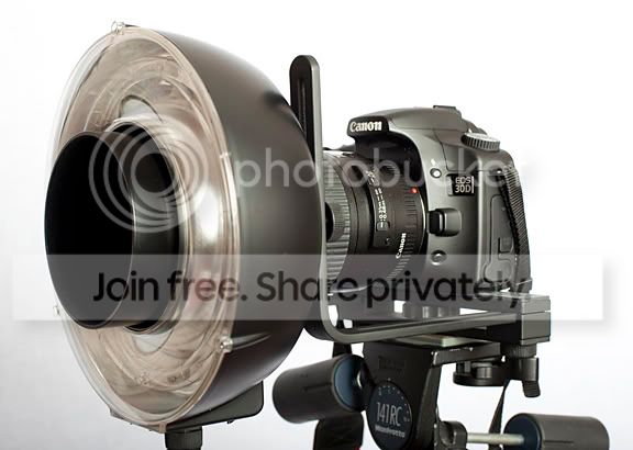

On opening the kit I was very impressed with the quality of the case, the supplied powerpack, faster battery charge adapter (you can also charge the battery in the powerpack although it is slower), mains adapter/charger and the ringflash itself. Yes the ringflash body is made of plastic, but can you imagine how heavy it would all be if made of metal? And, it is big. 19cms diameter with a 10cm diameter aperture for your lens to fit through. Also supplied was a radio trigger and a normal sync lead. I was disappointed to find that there was no instructions included other than how to put the ringflash components together to make the framework, although Garry Edwards did advise me that they were available to download from the website.
The picture below shows the ringflash head fitted to my 30D with the 100mm Macro and hood attached. I works and feels very good in this mode.
This is the models eye view of the ringflash unit.
I was pleased to discover yesterday that at ISO 50 and with the ringflash on its minimum power setting I could get 1:1 macro with my EF100 lens @ f32. As I did not have any means of making the flash power any lower I cut a piece of paper to fit the ringflash and was delighted to find it gave me a drop of almost 2 full stops as well as a more diffused light, I also cut a piece of paper to cover falf the head and this allowed me to introduce some limited modelling. I have now placed an order for a number of various scrims and ** gels from Lee to make some modifiers to vary the light output even more, this I feel will make the ringflash even more versatile.

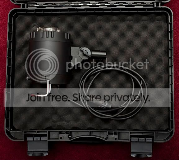

Later this afternoon I talked the grandchildren into posing in order for me to try out the flash head that I purchased at the same time as the ringflash and works with the Safari Powerpack to give me a powerful portable flash head.
The box that brought the powerpack head had the powerpack head/cable with its protective cap, and a handle, no instructions, no reflector even though in the site information it states one is supplied. The head though does seems very well made, the body is made of metal, and the fittings look like they will survive regular use. I was disappointed to find no instructions for the Safari 600 Head in the box, and the instructions available on the website do not cover the head well.

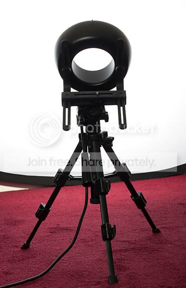

I set the ringflash up on a small tripod to act as a background light and aimed it at my white lastolight type background as seen here.

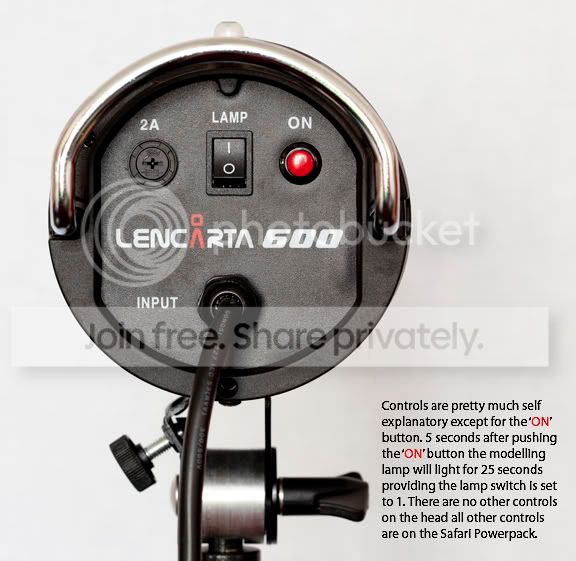

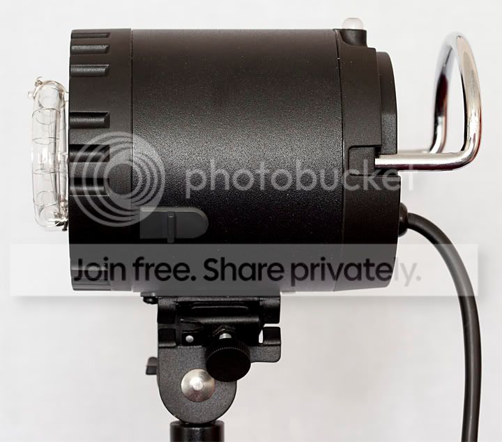

Okay folks, an update on the Safari 600 powerpack heads.
Firstly after a little practising I have now worked out the controls on the heads themselves. These are identified in the picture below.
Side View
