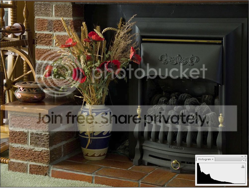

This morning I noticed the sun was shining through the French doors from one side of the room, and the widows on the opposite side were provide a similar but weaker side light to illuminate my black fire place. I closed the vertical blinds to soften the light. This led me to wonder how I would expose for this situation as the problems were fairly obvious.
I took three shots in raw, and saved them unaltered except for cropping and adding their histograms.
The first shot is with the camera set in aperture priority at Iso 200 (1/8 @F4)
As usual its automatic algorithms have reproduced the black fireplace as a mid grey and desaturated the vase and dried flower arrangement. But the Histogram looks good enough but a bit bright.
The second shot was taken with the incident reading taken towards the camera giving a manual exposure of 1/40 sec at F4 Iso 200. Saturation has greatly increased and the black is reproduced as its natural full black. The histogram favours the deep tones.
I took a third shot increasing the manual exposure to 1/20 sec at F4, as in the first shot, the colours are desaturated and the blacks have become greys but not quite as badly as in the first shot.
Using the Incident method has resolved two problems. Firstly it has coped with the extreme side light and secondly reproduce every thing to their original visual tones, and was not fooled by the large area of black in the shot. (had I pointed the meter at the stronger of the two light sources, the result would have been darker tones still, as that reading was close to 1/60 sec at F4)

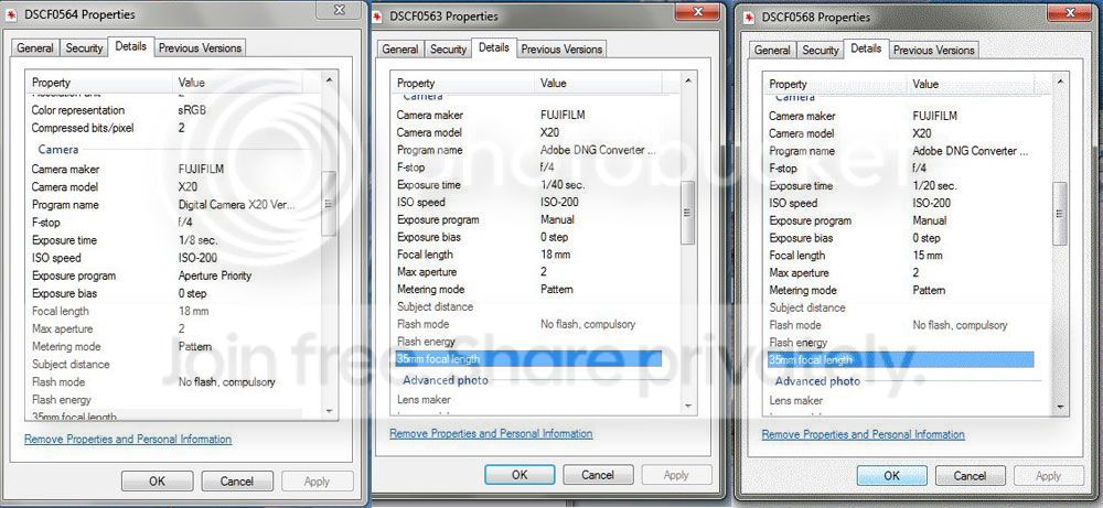

Are those figures correct ? a 1/40 sec at F4 and 1/2 sec at f2
Thanks
Have revise the OP first picture and exposure 1/8 @ F4
I pick up the wrong one.

These are the Exif data from the three shots.
Revised

The first was an in camera reflection reading taken in aperture priority, pointed at the centre of the shot... as expected it over exposed the blacks. this was a demonstration to show just this effect so no compensation was made.

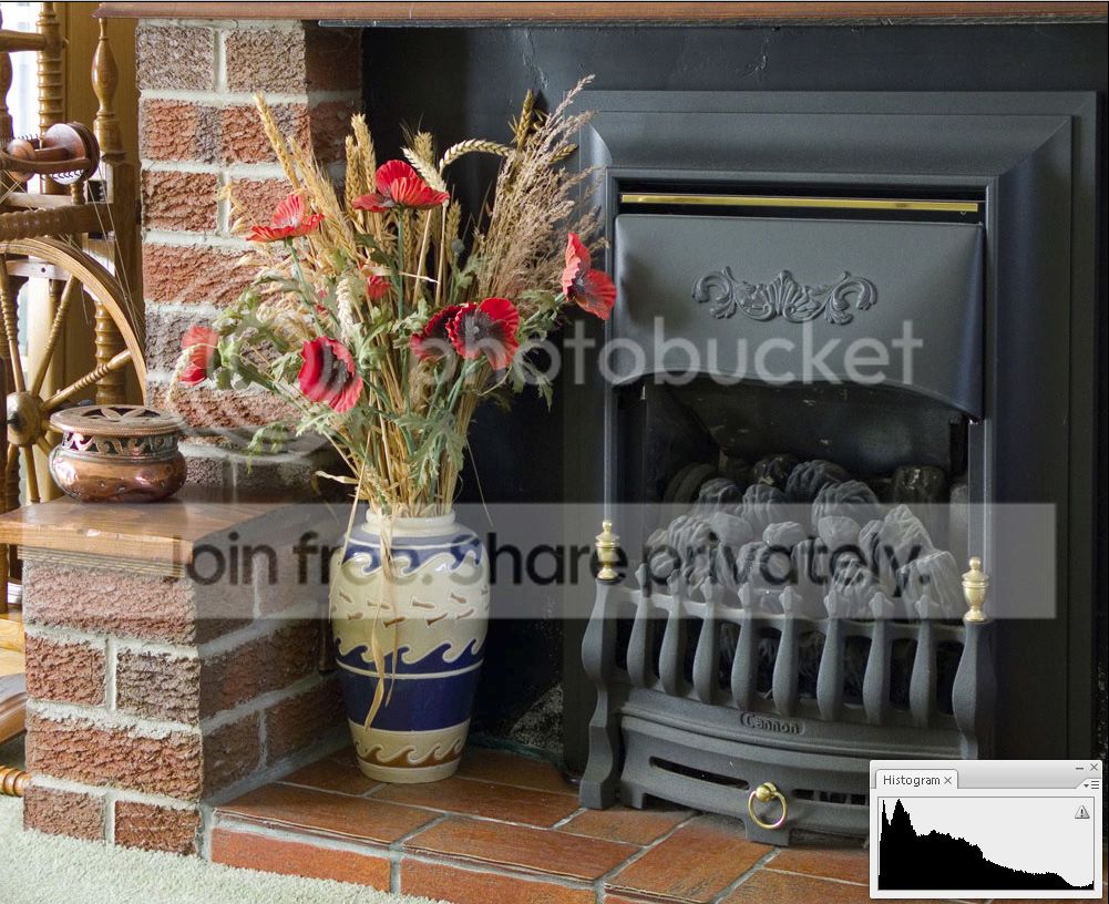

The second shot was made using the the incident meter as recommended, with the dome pointing to the camera. Sekonic meters have a claimed accuracy of 1/3 stop it would seem to be with in this expectation, and produced a result very close to the original subject luminance. Though I agree that an increase of about 1/4 to 1/3 stop might improve the rendition. however this can not be derived from the histogram. and I wanted the shot as read.

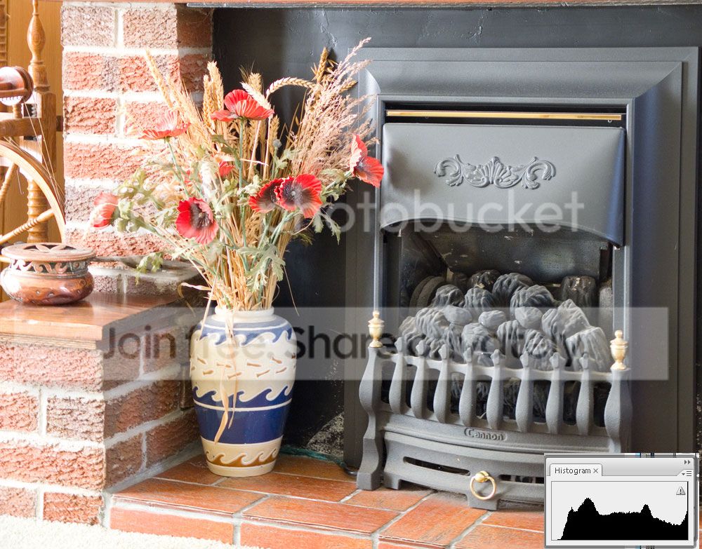

The third shot was using the same incident reading but I increased by a full stop as I suspected this would not be far off the first shot, though this prove a slight under estimate.
There has been no editing except for a slight crop.

however your maths is a little odd...
1/2 sec at F2.5 is the same as 1/3sec at F2
F4 @ 1/40 is equal to F2.8 @1/20 and equal to F2 @1/10
so the difference in exposure between the two shots is between 1/3 second and 1/10 second which is a factor of 3.3333 times = close to 1.5 stops which looks about right.

By far the closest to the original in both colour and tone is the second one. ( on my calibrated screen and in camera and in reality)
However many might prefer it slightly lighter which could easily be done in PP. (I happen to like well full tone well saturated results.)
The best result might be obtained by a little dodging on the second one, to just bring out a suggestion of detail in the deepest blacks..
There is indeed very little between the first and third as that was the intention, so as to show that a similar over expose poor result would be obtained by compensation by even one stop from the actual Incident reading.
I think your shutter speeds are going the wrong way there. You need a faster shutter speed as you open up the aperture...
You are right. I messed up there.
I have now put in the correct photo and exif data and histogram. The one I uploaded had been taken two or so hours later. In different light.
It now makes sense
I have found the error I put up the wrong first picture. ( the correct one is a good deal lighter.)
I will correct things this afternoon. I put up a shot I had taken later in error It was not till I checked the time that it fell in place.
The 2nd and 3rd shots are correct.
It is now all corrected

Of the three shots the middle one is very like the original indeed. (The light only measured under 80 foot candles) it is almost perfectly exposed.

Sorry for doubting you, but you surely must realise you posted an impossibility the first time around, and hence why you were being called into question :)

Not actually difficult at all... the first shot I took like a beginner, using the auto matrix with aperture priority, framing strait ahead, and of course it could not cope with all that strong black and recorded out a mid grey as expected.
Normally one would look for a neutral grey and use the exposure lock... and bobs your uncle.
The light was unusual in that it only came from the sides with nothing from the front. So would probably have given a rather strange reading from a grey card as even a slight directional change would have magnified any exposure difference.
For the second shot I pointed the dome at the camera as per the accepted method... though I did check what would happen if I pointed to the stronger sidelight, as there has been a lot of argument about that on the web recently... of course it indicated a slightly shorter exposure which would have further darkened the shot (definitely not what was needed)
No worries... It had me puzzled for some time... I had forgotten I had played around after having a sandwich lunch, and had taken another shot in the A priority mode. Same subject quite different light level. And of course such things fall butter side down.

You've got three photos, the first is overexposed, the second is underexposed and the third is roughly right. You're preaching incident light meters but the best exposed picture (as shown by the histogram too) is one where you took a reading and then adjusted it. Why take an incident reading and then adjust it when you can use the camera's meter and then adjust it?
I'm sorry but I really don't see a point in this thread at all :confused:
Then it is not for you.....
and it is clear you have not read or perhaps understood what I have written.
For your Information the middle shot is the correct exposure, with the tones and colours matching the original.
The one you like is washed out and has lost detail and saturation in all the tones, as explained in post#16
A modern trend has become for some to prefer somewhat over exposed shots as they can see more in the dark tones, but at the expense of the other tones.

I did try to "Improve the middle one in Photoshop yesterday. even opening it up 1/3 of a stop lost tonality and saturation. though a little burning did help to bring it back, but it was hardly worth the effort. If you look closely at the histogram of no 2 it contains tones to the right, it is Just that there are not many of them in the subject, but what there are in the grasses and vase and on the wheel are important so exposing further to the right just tends to lose detail or burn out these areas. which is what has happened in No3.
But as i say I will have a shot working the raw file from 3.

This is a Rework of number three from its raw file...
I had to reduce exposure by 1.35 increase vibrancy by +24, saturation by +8 and create a large s curve.
In photoshop cs3 I had to increase red by +8 and reduce blue by -8
All in all it was quite a fiddle to try to Get anywhere near Number 2.... which was arrived at with out doing any thing at all
even then it is not the same, just another version, that is a little too warm in comparison. and not as close to the real thing which is rather subdued. but I know some would prefer this greater saturation... which could be added to number 2 very simply. Not sure I would bother if I had a number to alter.
