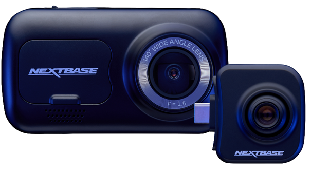

I have the Nextbase 522GW and rear camera. Works well when driving and has good image quality. Couple of niggles though, on two occasions now in about he last 6 months it has locked up and wont record, can't turn it off or reset so have to remove from the dock and wait for its internal battery to drain.
Also can't get the Alexa function to work, but I see this as a gimmick anyway so not really bothered.
The bigger problem I have is when parked overnight, in park mode the internal battery drains very quickly so after an hour or so it wont sense impacts or record so pretty pointless. It is hard wired into a switched live. I need to try a permanent live but not got round to it yet, but I think that will lose me the auto power on/off function.

The 522GW is the actual front facing dashcam and not hardwired at the moment, but am thinking about it as
it is a fairly easy job with the fuse box flap being on the side of the n/s of the dash, so easy access and you can
buy the wiring kit for £20, but then I'm not that worried as mine is normally parked up in a protected place at home
The rear facing camera just plugs into the side of the 522GW so you get a view through the rear screen, shows enough for my needs and easy to install
I'll get you some pictures of the view once I have the card and set thing up
