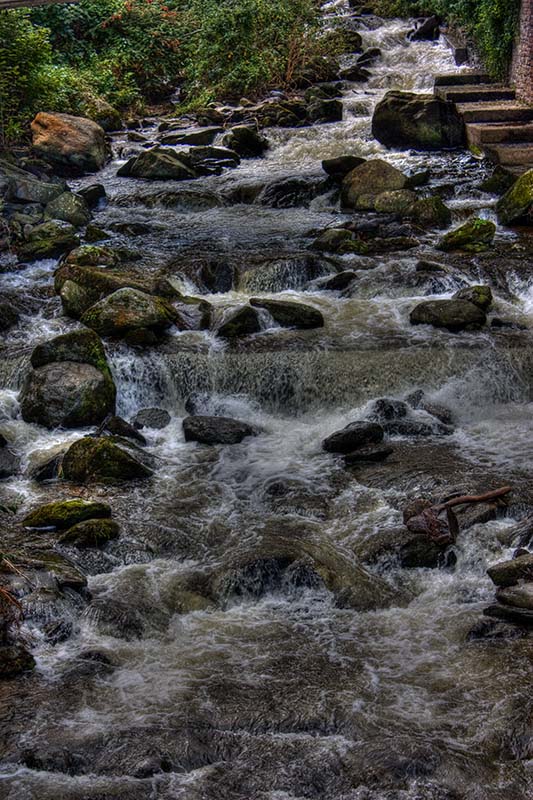

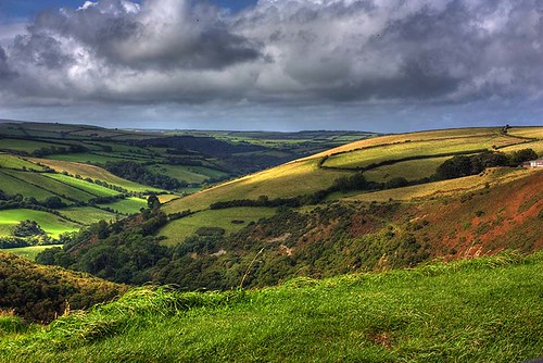

I have created some HDR images from single RAW files by exporting a copy at -2, -1, 0, +1 & +2 (shown below). I quite like this look and was wondering if there is a way to get the same sort of image directly from the single RAW file without doing the exporting & HDR.
