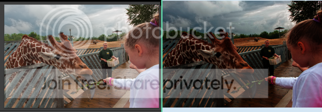

See above screenshot on the left is LR, on the right is the exported file in Windows Photo Viewer.

I'd forget about Photo Viewer or anything from M'soft for examining anything photographic - that's just a sad fact of life. Look elsewhere. It's tedious, I know.
@chris-red
Re-profile your system using ICC v.2 profiling, NOT v.4 (this should be in the color munki preferences)
Windows doesn't play nice with V4.
That will sort it... but you will have to re-profile after you've set it to V2.0 in order to set the new v2 profile as system default for windows colour management.
That's NOT it... If he does any of that, he'll remove his screen profiling!!! @chris-red .. do NOT follow the advice in the above links! It will fix your windows viewer issue, but you'll no longer be profiled using your color munki !
His system is obviously profiled already as he's using the color munki software, but he's using the wrong ICC version. Common problem this.
@neil_g
Had the same issue myself Neil. I can pretty much guarantee it's v4.0 ICC profile causing the issue, and it's not a problem with the image's embedded profile, but the profile set as system default, which would have been created when he profiled with his Color Munki.
..I could be wrong though.. LOL
We;ll find out in due course :)

@chris-red
Thanks I'd already read the first links posted and disregarded it, I'll have a go tonight. It's very strange I don't remember re profiling recently and this only seems to have happened in the last few weeks. Hopefully I'll get time to have a look tonight if not it'll be Wednesday. I'll let ya'll know how it goes.
Please do, as if it's not the v4.0 problem it's a mystery. I like mysteries :)
