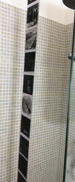

Found the tank, with a mod 54 insert in it.
Found a second tank …..with another mod 54 insert inside it.
Grovelled around in the depths and came across a tiny single spiral tank with a spiral in it but only for 35mm film!
Jobo tank and LF spirals located , then hallelujah, a tank system four withfive suitable spirals hidden inside .
Loading , even with the film corners cut and working on the bench worktop in the darkroom didn’t initially look promising with the film jamming and trying to crease.
My initial comments after b*ll*x were , ´I wonder if this isn’t why I gave up on roll film ‘ lol
A deep breath , a pause and more patience got the film to play ball.
So to the wet side
A half liter of chems seemed like a huge amount compared to typicallyusing a fifth of that!
Similarly 9 mins and agitating by hand felt somewhat strange ( with the orbital I have a motorised base), however, I have 12 decent looking negatives , one or two perhaps a tad overexposed but having looked at the yellow filter, it only requires a third stop compensation, (out of habit I allowed a full stop.)
The spacing appears to be ok , as does the focusing and there’s no indication of light leakage so overall an excellent result and confirmation that thé yashica functions just fine.
