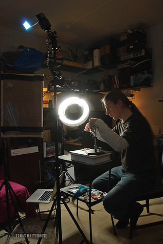

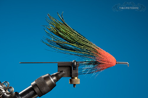

I've also used the ringlfash as a key light for some smaller product work, this was diffused with a softlight reflector though as direct and un-diffused it can be a little too hard for my tastes.
Profoto D4 ringlight, AcuteB 600R and softlight reflector.
