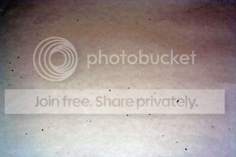

I remember reading a thread on here "post your sensor" that had instructions on how to take a photo of something white that will show up sensor dust... but I can't find the thread! :bang:
What do I need to do? Set the focus to infinity? Open to the widest apeture? :help:
Best method I use is shoot a picture of a clear blue sky (if possible) at f16+ or there abouts, the focus shouldnt really matter because the details your looking for are on the sensor.
Then I think you do an auto levels in photoshop.
Warspite has it just about spot on.
You just need a bright (white is best) background and crank your fave lens tight shut f16..22..32. Dont worry about the speed. It doesnt matter since what you are exposing is the crud on your sensor. Anywhere from 100th or slower will generally do.
Then zoom in to about 100% and do the space invader walk across your image. If you've big bits of crud then you wont even need to do this it'll stand out like a polar bear in an ice storm (the nose)
I found the easiest way to check for dust is too take a photo of a peice of white paper with a small apature. make sure it is out of focus incase you mistake a mark on the paper as dust. then simply look at the photo and see where the dark spots are. thats how i test and it works every time. The white paper maximises contrast so its easier to spot the dust.

Get yourself some PecPads (they sell specific types for each camera) from WarehouseExpress and some eclipse fluid.
Another vote for the pec pads and eclipse fluid. Just shoot at a plain wall in your house at f22 or smaller and those dust specs are scary! If you don't shoot at very small appertures then you might not need to worry too much about cleaning :-)
yeah, I never noticed it until I was out yesterday taking pics of birds in the sky. :(

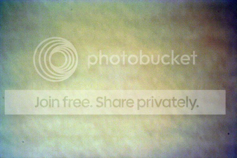

Thought I'd update this thread. I received the Eclipse fluid and Pec Pad this morning and I just cleaned my sensor. This is the result after 4 goes:
Not perfect, but MUCH better than last week (see post #6 above).
There was one particularly stubborn dust that wouldn't come off. I put double Pec Pad on one glue stick and dabbed it with more Eclipse fluid that normal and gave the part with the stubborn dust a good scrub. :lol: Finally it came off. I think this is probably the cleanest I can get it. From the 3rd to 4th clean, I've reduced two specks but moved the rest around a bit. I think I'll wait to accummulate more dust before cleaning again.
Thanks to RobertP for posting his "Howto" guide. :clap:
I'd be careful about giving the sensor a "good scrub"!!
As I think I said in the guide.... I had to 'scrub' a stubborn spot first time I cleaned and it took 7 goes to get it clean (so 14 swabs).
It is always a judgement call when to stop. I think you could do better than that kamion - but you don't need to :)
