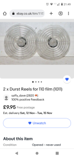

Yet another 110 - 16mm developing option:
