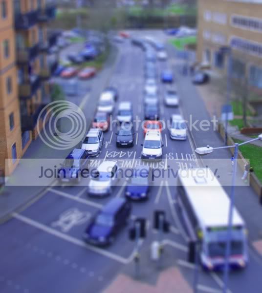

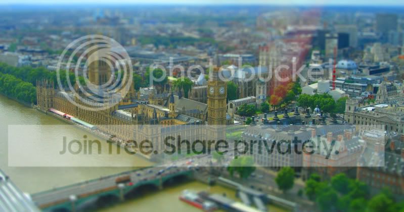

Just had a play in CS5 with a couple of old pictures
Chris - I think it's down to visual perception, the depth of field of human vision decreases as the subject is brought closer to your eye. Try threading a needle and you'll notice the effect.

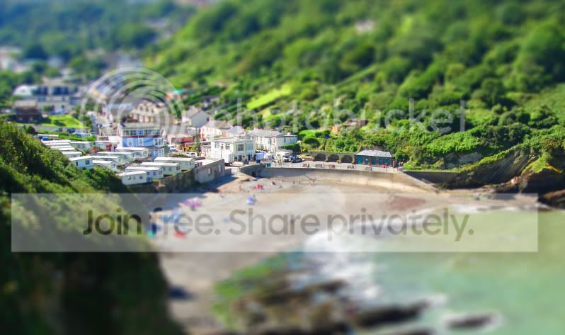

Paul - the effect always looks better to me when the in-focus area (either genuine or faked) contains something on a human scale, either people or a vehicle. I think the beach shot would work better if the unblurred zone was lowered to pick-up the figures on the beach. But the beach example also shows the inherent problems with faking the effect, you couldn't logically have part of the near headland in focus as well as part of the far headland and part of the far beach without having everything inbetween them in focus.

Yeah they are bad pics to start with, London was from the eye so lots of reflection and dirt on the windows and the beach wasnt in complete focus to start with. Both taken years ago and the only thing i had to try with but i love the effect.

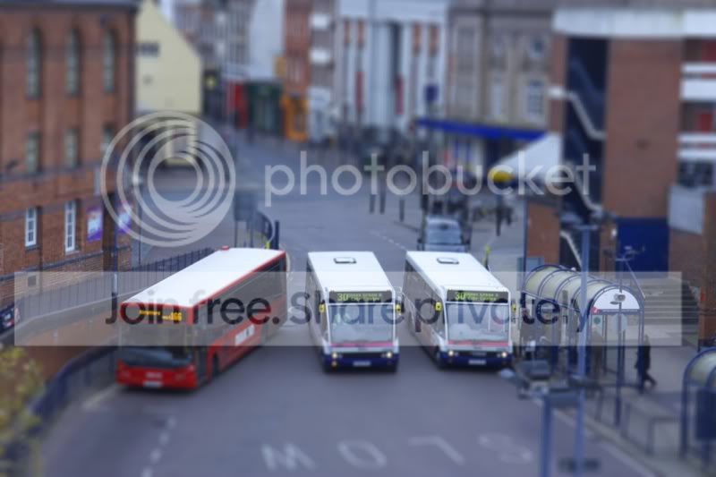

have a butchers here - some of the best i've ever seen :D
Yeah some really nice ones there. I think the secret is to have a subject that could be a model and thats why the train station one works.
