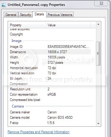

dimensions i have for it when looking through windows properties are:

Divide the pixel size by the DPI to get actual size. Your current DPI is 72, which is fine for onscreen viewing. Up that to 300dpi for a decent quality gloss print, or 200 should be reasonable for a canvas print.

18006 x 3727 pixels translates to about 60" x 12" when printed at 300dpi.
