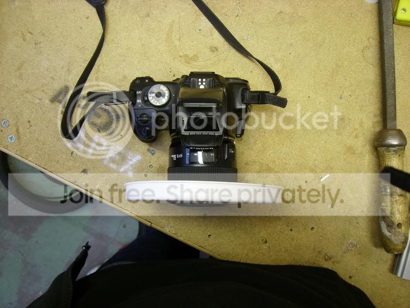

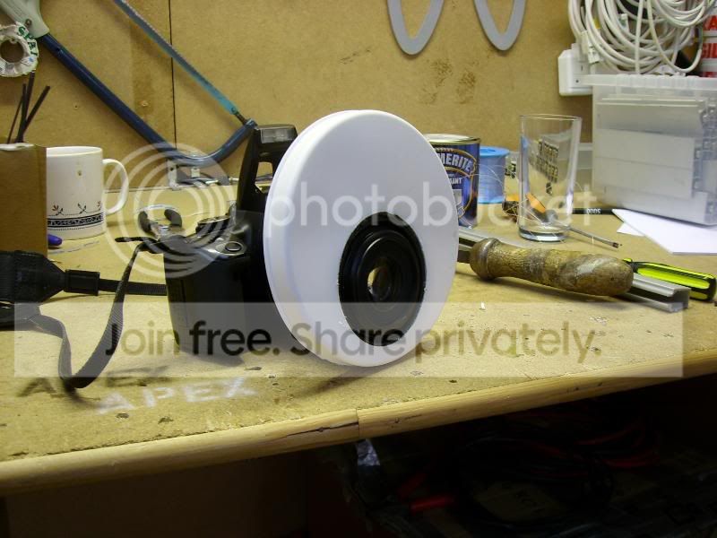

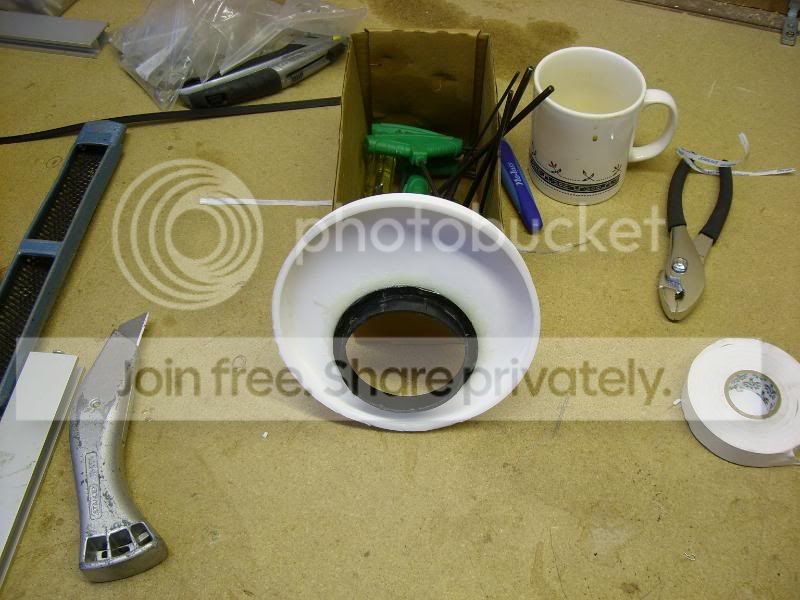

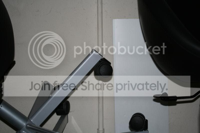

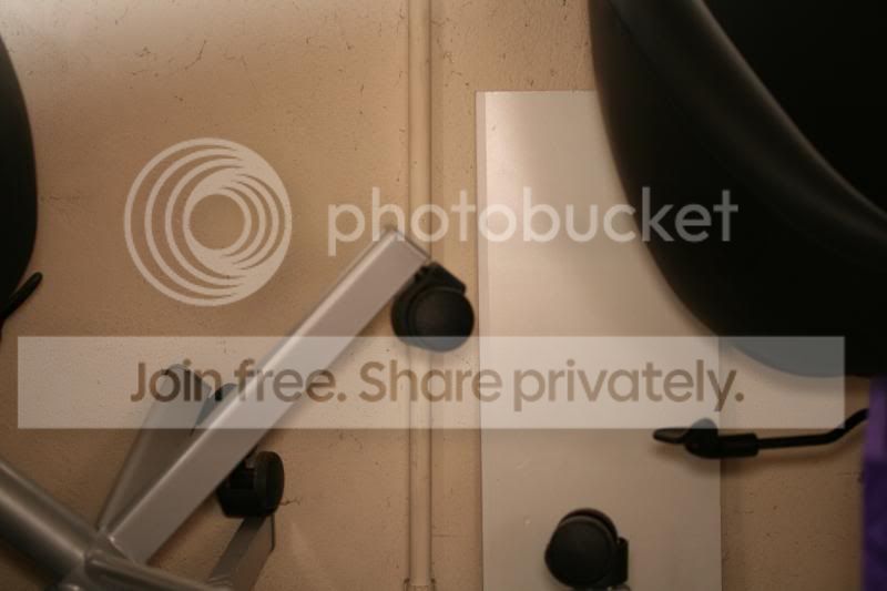

Just thought i would post up an experiment ive done today. Ive made a home made diffuser for a camera with an on board flash. Ive just gone and taken some test shots with it and im pretty pleased with the improvment! Obviously it works on some pictures better than others, how close you are will make a difference ect. Here are the test shots and a shot of it on the camera :)
It clearly makes the flash alot les harsh and flat which as we know is the downside to a poo on board flash
Without Diffuser
With Diffuser
Without Diffuser
With Diffuser

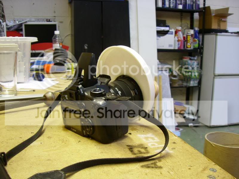

And some pics of what it looks like, on and off the camera
C&C welcome as always

I made this gadget as i was sick of the real harsh flash you get off the on camera flash

Little diffusers like that make some difference if you're really close, as the flash becomes relatively bigger compared to the subject. At distance though, the effect is negligible.
It's making some difference inside your light walled garage as the light is bouncing around all over the place, softening and filling in the shadows by reflection. It also looks like the flash is running out of puff to do this in one or two pics, as it spreads light everywhere and uses a lot of power.
To see what effect the diffuser is having on its own, shoot something outside when it's dark where there is no light being bounced back from walls and ceilling etc, at normal shooting distance. Prepare to be disapointed though - the major difference will be that the flash will have no range at all and the light will be virtually identical both with and without the diffuser :(
