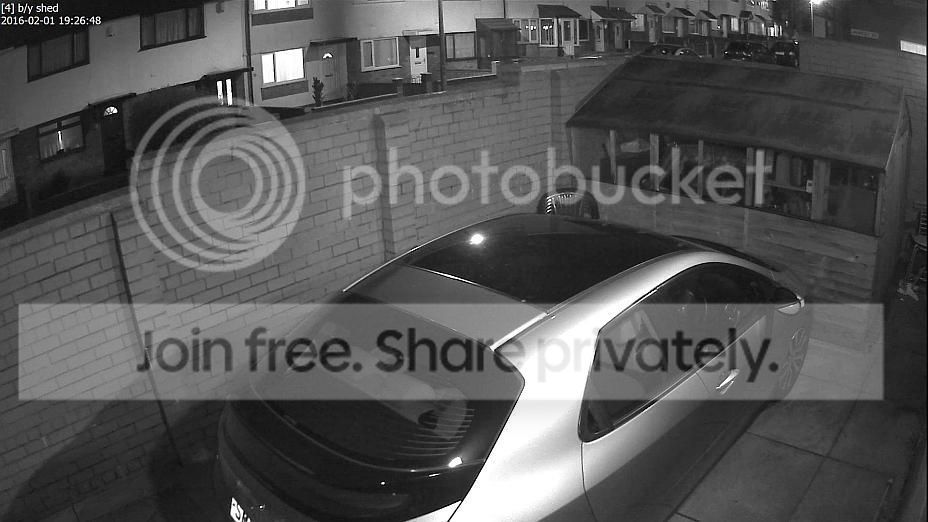

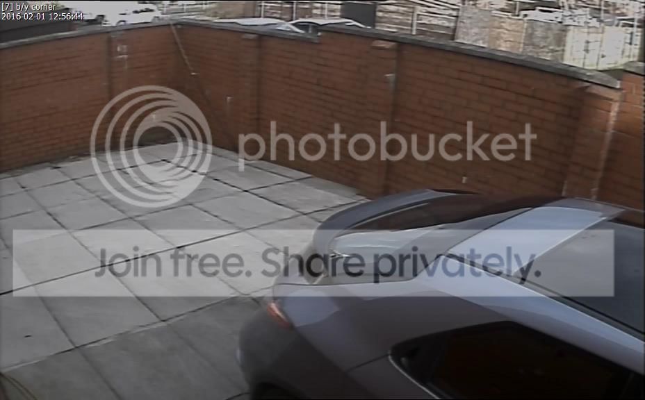

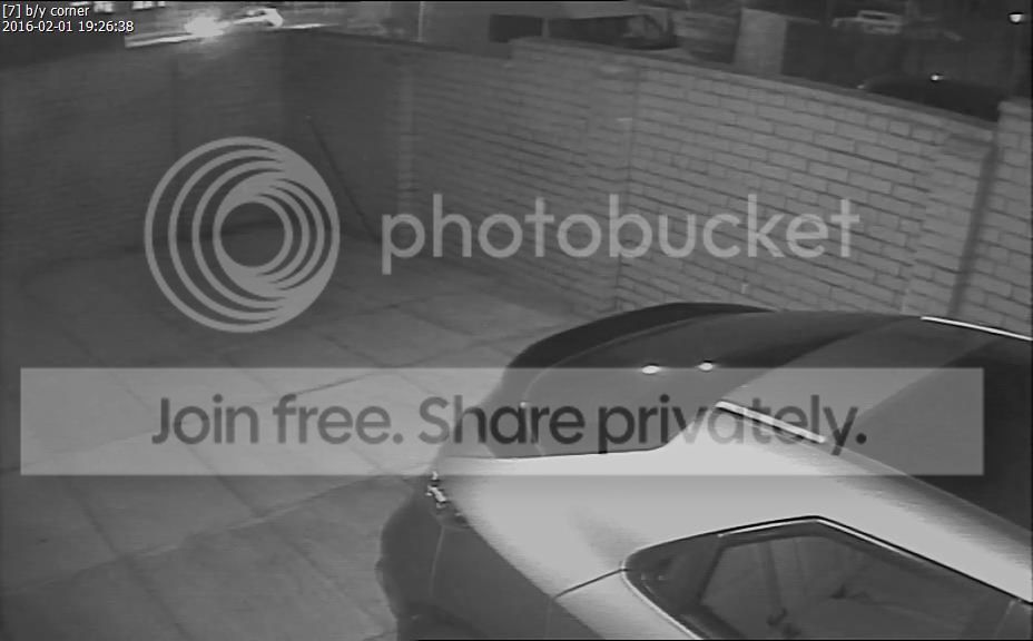

i have one of the cameras used in that kit connected to a samsung hybrid ( HD and SD cameras ) setup and for the money there not bad, night vision is better than i expected too
Night 960H SD
Day 960H SD
the day capture is a little dull because i have the camera set up that way it's easier to brighten an image than it is to try and get detail back into blown highlights

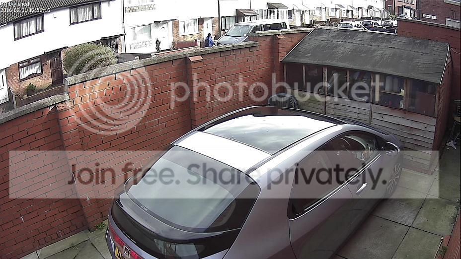

for a few extra quid you can go for HD cameras and DVR and to be honest that is what i would recommend the image quality is worth the extra spend
Night 1080p HD
Day 1080p HD
which HD system to go for i don't know, i went for the samsung hybrid system and i'm quite happy with it for the price
the only bugbear is you have to purchase samsungs HD cameras which tend to sell for around 100 quid each which brings the price of a 4 camera 1080p HD system to over twice what you want to spend
