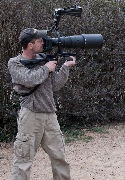

Or you could combine them. 500/4 w/ gripped body shown; I normally use it with a D4/D810 gripped and 400/2.8 (usually w/ TC @ 800mm).
I've never fount photo sniper a particular advantage over just holding the camera properly with one hand on the body and one on the lens / lens foot.... also in this day and age i'm not sure making your camera look more like a gun is a wise move
Never had an issue, and no-one has ever reported having an issue. Quite the contrary actually; the people with guns/cameras know the difference. But I don't walk around the city with it. If you can normally handhold 7+ kgs stable for any length of time I would be impressed.

I can imagine that grip would make it easier to get elevation whilst still being able to keep your elbow tucked in against your body.
The only issue there is that you've got very little chance of reaching for your zoom ring quickly if you've got a zoom lens. I guess most big lenses are primes so not a huge issue but my 200-400 has both a zoom ring and a decent amount of weight lo.
