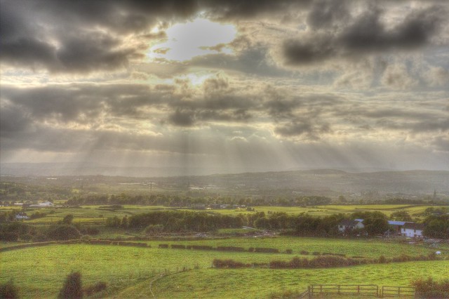

I'd love to know how I can improve on this shot. We went for a walk the other evening and the suns rays were beaming down on the hills.
How can I improve the sky and still get all the rays coming through?

The shot does look a little hazey, you could of tried with a tripod and done something along the HDR lines? Try putting this shot into Photoshop or a similar program and check your white balance settings
Here is a very quick and rough edit in lightroom using the small jpg from here.
I think with the RAW file you could make something from this shot. Ideally you'd want an ND grad on the camera to balance the sky and foreground.

My attempt -
I agree with Tom about the RAW. The limiting factor in the picture is the very bright part of the sky.

An ND grad might help a little.
raw is really required for these lighting conditions. you did fairly well but a bit of processing is required to get the best out of this shot. it's really nice by the way!
also i think you underexposed it a little. and i would have shot this so the big sun ball was cropped off the top.

A "soft" ND grad would be the best type of filter for this. Soft meaning that the graduation is over a greater distance than a "hard" ND grad.

As per what some of the other guys have said; an ND Filter would help expose your shot better.
Use a tripod as well, and try for a HDR shot - 3-5 shots using your camera's AEB Function (auto exposure bracketing) - it will take shots under & over exposed. Then just merge these using a photoshop or Photomatix.
* Also i noticed you had ISO 200, try going lower, 50-100 - this will help.

Underexposing is good though if you shoot in Raw. You can pull back details from under exposed shadows, but not from overexposed highlights

I took this in RAW how what can I do to pull the exposure back?
you can recover a bit of the highlights, but not a great deal. But equally, if you raise the exposure too much in PP then I find my shots get very grainy
I would say the third one is yhe best. You have managed to keep the dramatic sky and pull the land out quick nicely.
