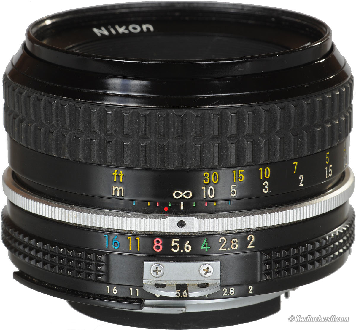

OK I need someone who can without any doubt confirm wether this is an AI or NON AI lens.
Definitely AI, you can tell by the ridge on rear of the lens.
C
AI. 2 rows of aperture numbers, serial number, coupling ridge, lowest f/stop is not orange (that would be AI-S), holes in the rabbit ears.
I was drawn to think AI too until I read this
Quote (2nd Paragraph)
"The most distinctive characteristics of the Non-AI lenses are the metering prong without “nostrils” (2 smaller holes on either side of the opening) and the plain stainless steel base with 5 mounting screws."
Totally confused as the prong on the lens I've posted does have "nostrils which would suggest AI but the base plate has 5 mounting screws which suggests NON AI
Will be cool if it is AI then as would work on my F/60 / D50 / D80 (albiet with mf and no metering) as well as perfectly on my FE
OK, here's why you're confused:
This is a lens that started life pre-AI. Often known as K series, in that it has the same general cosmetic design as the later lenses, it is very different looking to previous pre-AI lenses which didn't have the rubber grip around the focusing ring, for instance, and had a metal scalloped variety instead.
Its serial number puts it smack in the middle of this group of lenses. See here:
http://www.photosynthesis.co.nz/nikon/lenses.html#50slow
Subsequently, it has received the official Nikon conversion to AI, using a new AI aperture ring.
So it is indeed an AI lens, or strictly speaking an AI-converted lens. However in every practical sense it is exactly the same as the slightly later AI version.
So feel free to use on your newer bodies.
It is also a beauty (I have one myself) - a fantastic performer (at least on film, anyway).

Thank you ever so much for the clarification guys.....Naturally the last thing I wanted to was try it on a digi body and s**** the lens and/or camera body.
Just tried it on the D50 :
Cool or what:thumbs:

Non/Pre-AI will mount but it don't meter like an AI lens will. Easiest way to tell an AI from Non-AI is that AI/AI'd/AI-s/AF/AF-D lenses all have two rows of aperture numbers on the lens.

I don't know for sure tbh but I would hazard a guess to believe there may be a collision between mirror and rear element of lens thus causing damage.....From what I understand this was more of a problem with Canon than with Nikon.
No doubt one of the old croners :D will crawl out the woodwork with a thorough response to settle the most mechanically engineered minds.
In the case of the FM2n, it won't fit, and forcing it will break something. It says so in the camera manual and having very gently tried it I am inclined to accept that. Don't know about other cameras, but Asha's link looks about right.

I've found that they don't fit it's because the depth of the very back part of the lens (where the aperture index 'ridge' is on AI lenses) is slightly greater with non-ai lenses which causes a very tight fit - so you can't move the aperture ring - or not at all. Grinding this down and cutting the correct ridge out is basically how you DIY convert a lens to AI
Most DIY AI conversions just file out a slot in the existing ring. I suppose what they mean then is an AI converted lens must be properly converted with a new aperture ring which is flush with the mating face of the lens mount rather than overhanging like the pre AI types.
Just taking out a small area for the coupling wouldn't be enough.
And I have no intention of machining down the aperture rings of my pre AI lenses!

To the best of my knowledge:
Basically, a pre-AI lens has a solid piece of metal at the lens mount side - on an AI/AI-S/AF/AF-D lens, this line of metal is partly filed away to interact with the AI coupling mechanism. This is a small stub around the Nikon F lens mount that should be visible on most film Nikons, and most prosumer digital Nikons.
Mounting a pre-AI lens on a camera that is built for AI and later means that the metal will strike and potentially damage this AI coupling mechanism.
This is the reason why you can usually mount pre-AI lenses on entry level Nikons - the very ones that do not have compatibility with the older lenses, because they have no means of gauging aperture via the AI coupling mechanism.

Slight correction of detail: the tab can also be flipped on a few others in exactly the same way: Nikkormat FT3, EL2, FM, F3, F4 off the top of my head. Also on the later AI version F2 models (F2A, F2AS) there is a similar function. How geeky am I....

Importantly, this function doesn't necessarily follow form - for instance, you can do it on the FE/FM but not the FE2/FM2/FM3A.
As far as I am aware, the D3200 does not have the AI tab on the body and I know my D100 doesn't (unless it was hiding from me) yet I see advice saying not to mount pre AI lenses on a D3200.
As you imply, if these cameras did have the tab, they could meter AI lenses.

Have a look at the table about a third of the way down this page: http://www.bythom.com/lensacronyms.htm
assuming that the D1 and D100 would both have tabs (I believe the D1 does, not your D100 indeed).
It fits fine on the D100. If it wasn't broken I could tell you if it works. However, the table in the page I linked to above says do not mount on a D100!
One more quote from that Flickr group:
Since the D3100 and a lot of other entry-level cameras don't meter with non-CPU lenses this aperture coupling isn't there. That's why you can use non-AI lenses with no problem.
That's what I originally thought. If there is no AI tab on the camera then the lens doesn't have to be AI to mount. Doesn't explain the D100 exception though.
