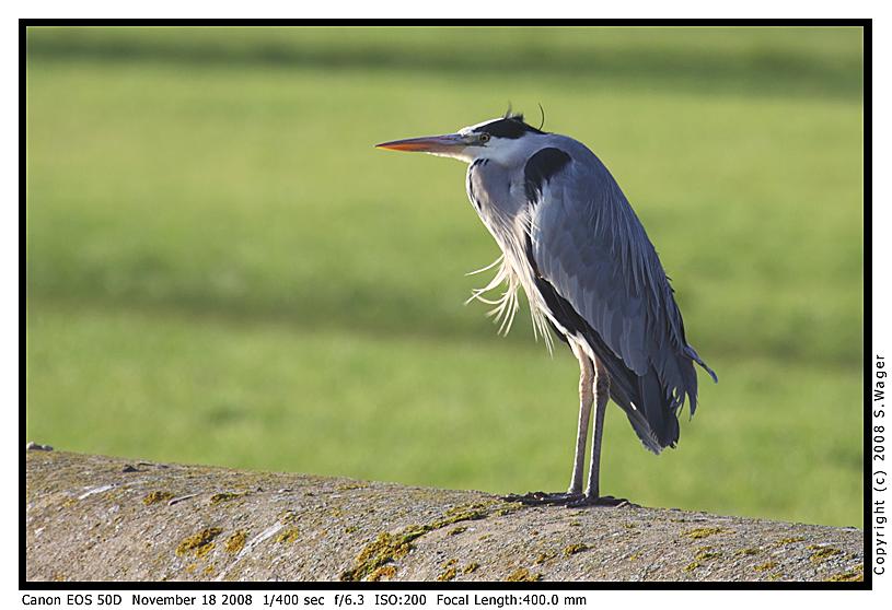

Cheers for all your help guys - Certainly haven't found any of it patronising. Below is a picture of my 100-400 wide open (I know it's been posted before, sorry). Looking at this, am I just worrying uneccessarily?
I also think I am just in the position of not being able to use the lens out and about too much as the light etc is crap by the time I get home. So when I do try, the conditions are pretty poor. I know that this lens loves light, so I'll just have to wait for the sun!!
Sara, was this shot raw originally ? is it a crop of a larger image ? and one more question, what is your post processing regime used on this picture ?
It actually looks fine to me, it might take a little more sharpening but i dont see anything that would scream the lens was at fault ?
This was shot in RAW and was a crop of about a third of the original picture (At a guess) Post processing I would say probably got a curve and a saturation and sharpen at the end. Is this OK then?
I am interested by a previous comment about my CR2 turning into a TIFF file - All of mine do once passed through DPP. Isn't this normal?
Well if you are supplying an unedited original image file, why are you passing it through DPP at all? You could have simply uploaded the original .CR2 file. It would have been a smaller upload (and download :) ) and would have been a sure guarantee that there was no accidental alteration, or degradation of the file.
If you want to output a processed image, even with no additional edits, you do have the option of JPEG instead of TIF, which would have been far, far smaller, but for these purposes the original CR2 would have been the best option.
