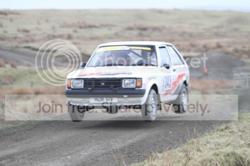

Hi Guys,
This is going to sound incredibly stupid but i am pulling my hair out as to what im doing wrong.
First my set up i was using Canon 7d F2.8 L 70 - 200mm and a cheap ebay polorising filter.
I was trying to take photos of the Rally cars in wales yesterday and no matter what i did i could not get the shots in focus. Every shot is just out of focus and in the end i just kept my finger on the button hopeing one out of the sequence would come right.
I had the AF set on servo mode.
Many thanks for putting up with this obvious idiot question.
Cheers
Rich

Thats about what i can remember. I hope it is the filter as it is an expensive problem with the lens maybe. Having now looked at the pics the focus is worse the further away and all the photos apear to be missing colout they look very flat.

Bad filters can do serious harm to IQ and the effect is worse at longer focal lengths. If you use a linear polariser instead of a circular polariser then that can actually b****r up the AF as well (not permanently, just while fitted). If you want to troubleshoot you really should get that filter off the lens and go back to basics - static subject, good light, tripod if poss and see how you do. There is much that could be wrong, but with that filter in the equation you might have a hard job pinning it down. Of course, the filter might actually be OK, but "cheap eBay filter" does lead one to point the finger at the filter in the first instance.
Of course, poor technique or unsuitable shutter speed can lead to shake/blur, which might be mistaken for poor focus. There's lots to ponder. I'd still take the filter off and see where you stand to begin with.

I'll take a punt and say it is the polarising filter. Cheap polarisers are fatal on longer lenses - nothing to do with the linear/circular bit, just the poor grade polarising foil which gets magnified with focal length.
Polarisers are good for saloon car racing as the angles are just right to cut reflections from the windscreen, as it has done there. I use a Hoya HD CPL on my 70-200 with no sharpness issues, and the fact that it loses about 2/3rds of a stop less light than other polarisers is particularly handy when you need higher shutter speeds.
Its just lost its sharpness rather than being out of focus, i would say filter.
Was there any particular reason why you were using a polarising filter at all, apart from protecting the lens? They're not designed for this. Try a good UV or clear protection filter if this is what you want.
Thanks for all the help guys. The only reason that that filter was used it was the only one to hand as this was the first time out with this lens. Filter now in bin and getting a Hoya set ready for the next rally.
