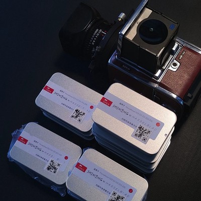

I just found these Chris (in case you get a WLF):

Thanks.
I found those but they are -ve values only.
