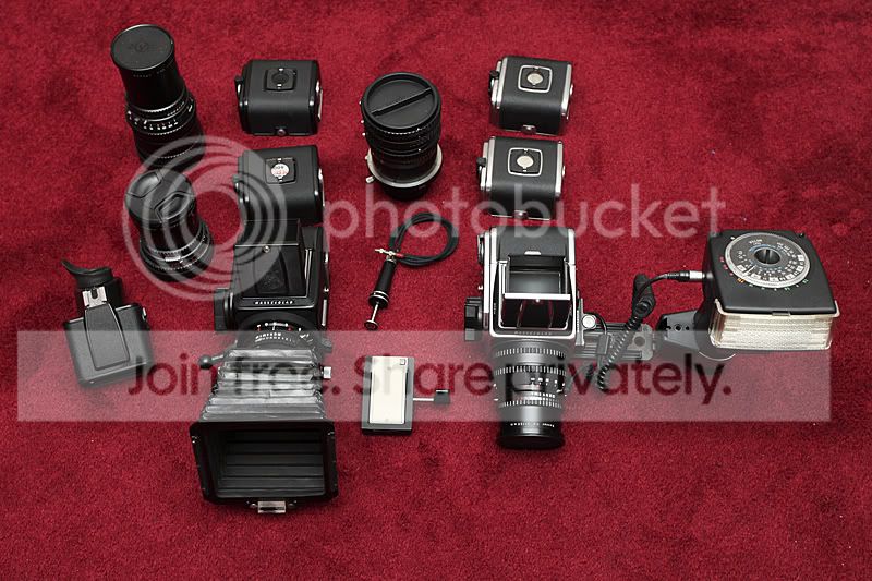

Spent £100 on my Blads today, bought a mint focusing handle No1 £15, a New Rapid Winding Crank £15, Hasselblad Dual Cable Release £20 & a very nice Black WLF for my Black 500CM (which came with a PME-5 prism)
My Hasselblad Outfit:
500CM Black WLF, 503CX Chrome WLF, 50mm Distagon C T*, 80mm Planar C T*, 150mm Sonnar C T* & 250mm Sonnar C T* lenses (all black), PME-5 Prism, 10mm, 21mm & 55mm Extension tubes, 2x Black A12, 1x Black A16 (6x4.5), 1x Chrome A12 & 2x Chrome A16 (6x4.5). 2x Hasselblad Tripod mounts and a Hasselblad spirit level. Hasselblad Proflash Outfit 4504.
Just need a cover for the base of the Prism finder now if you come across one.
I might take a piccie of it all later as the first picture on my new 5DMk2.
Just need a cover for the base of the Prism finder now if you come across one.,

I might take a piccie of it all later as the first picture on my new 5DMk2.[/QUOTE]

Not the best image, but number 1 on my new camera.
