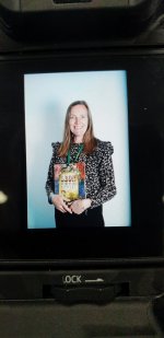

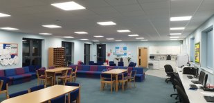

Thanks for the reply's the staff room is quite big and bright I had a quick go when I came home and the results weren't that bad so I'm going a bit early tomorrow and set up and have a few test shots you can only try your best
Sean

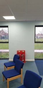

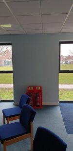

Quick tip
Don’t use that wall as a BG, use those windows as a light source.
Use your pop up background instead
Of the back of the camera not to bad hopefully when there they have gone though lightroom
Sean
