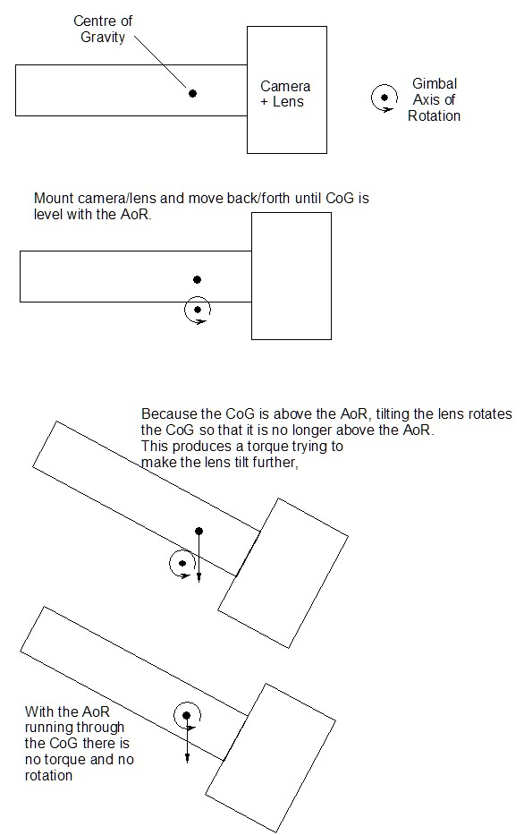

Whatever you get, make sure you can adjust the height of the lens. Otherwise it's impossible to get everything balanced. The 393, as far as I can recall, does not allow fine adjustment of the height. That means you're likely to have the pivot axis of the lens well below the centre of gravity, like this image here. As soon as this lens is tilted there will be a torque that will act to rotate the lens back to the horizontal. You'll need to add friction to hold the lens in place.
With a proper gimbal, properly adjusted, the pivot axis will pass through the centre of gravity. You can tilt the lens to any position and it will stay there with no added friction. You can move the lens in any direction - up, down, left, right - with just the lightest touch. Here's a well-centred gimbal LINK

You can balance it in one direction. Without an up/down adjustment you can't balance it properly.
Why is up/down needed? (genuine question)
To get dead centre of gravity you need to balance the lens back and forth then depending on the gimbal raise or lower the inner arm so the centre of the lens is in line with the pivot point .
This will then let you fully slacken off the adjusting / friction screws and if you move the lens it will stay in position.
To leave it like that it would swing round in a slight breeze so you then have to add friction to make it more stable so it would most likely stay in position even if it wasn't at the centre of gravity.
Some gimbals don't need to be raised to get the same type of effect simply by adding a little friction in the first place, they will still move freely and stay in position too.

It all depends. In many cases the lens diameter, the height of the foot and the height of the gimbal will all combine so that the CoG and AoR align by chance. But, if you want to be certain that they will align, so that no friction is required, then you need to be able to adjust the height.
The picture you link to shows the case where the user was lucky. This image -link - shows the case where the 393 is totally the wrong height.
