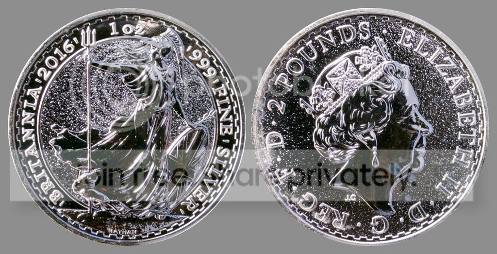

I am trying to get pictures of some proof silver coins and seem just unable to understand how to control light.
Look at this picture of a 2016 Britannia:-
Would you know that it was wholly a silver colour from the photo? Certainly some areas would look far better with the light bouncing differently.
I mount the camera on a tripod and focus down using one or two external constant lights (LEDs). I have moved lights 360 around the coin then again using one light. I have diffused the light from the lights, made a simple soft box with cotton sheet with the lights outside. I have tried bouncing reflected light and always seem to get the same effect.

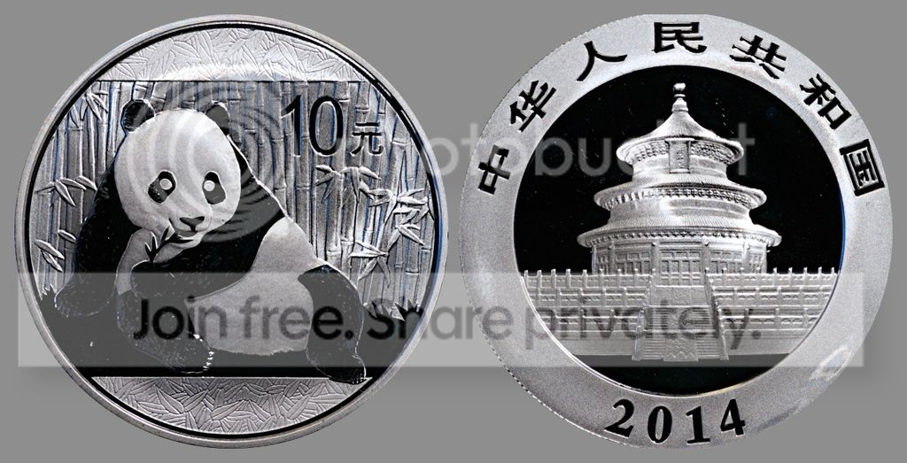

Now don't get me wrong, the error sometimes works out for as with this 2014 Panda:-
The Panda accidentally looks right and the temple and stairs also are fine. Please understand that win the hand both the Britannia and the Panda look like shiny silver with frosting and etching.

You need to reduce the lighting ratio so that it's all about even. I would use one as diffused fill (from above) and the second as a harder cross light (from side/shallow angle) in order to bring out the texture/detail.
Thanks. I *think* you are putting me onto the right tracks but this is going to take some working out. I think that the light needs to be more diffused and accidentally I didn't put the coin flat with the 'head' shot. The head is overblown but at least more silvery.

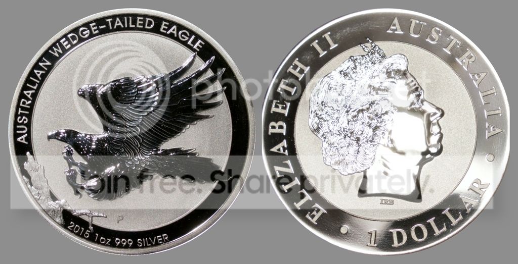

The problem is that the frosting bounces the light in all different directions so what is right with one is wrong with the other. The texture in the eagle is better with the cross light but still not silvery. The Queen is (overblown) silvery but the majority of the inner rim is black.

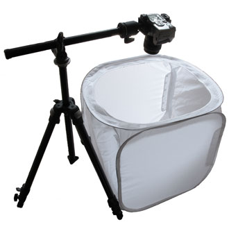

How about 360 degree lighting via a softbox enclosure used for product shots.
ie put the coins inside the softbox with lights outside the cloth and the softbox on its back so the coin can lay flat and have a tripod that can go at 90 degrees and face down over the coins.
I'd hope the diffused lighting would oppose itself coming from all angles to stop the reflections.
What do you feel?
This is what I was meaning but of course with lights surrounding as felt needed.

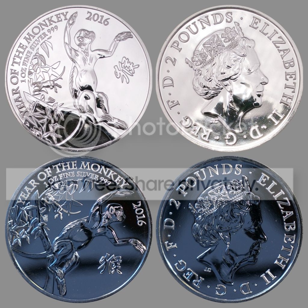

I cannot help with your lighting problems but I must say those are rather nice coins, is it a hobby of yours. ?
Just been on the Royal Mint website to look for the Monkey £2 coins and they are not cheap, but probably a good investment.
