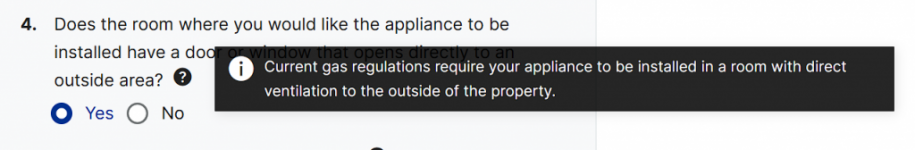

I have a gas cooker (one those free standing ones that combines oven and hob). I want to replace it pending a complete kitchen refurb in about 2 years where we'll swap to electric. The current cooker has a bayonet fitting and a 3 pin plug for the ignitors. I already know that I either have to get a gas engineer to "plug" it in to the gas or do it myself and then get a gas engineer to check it. So whatever happens, a gas safe person will visit.
My question is ventilation. The kitchen has double doors to a large conservatory and a single door to a utility room which is a brick and double glazed lean to. It also obviously has a door to the rest of the house. All of these doors are within 3 metres of the cooker. Over the cooker is an extractor fan which I believe to be recirculating.
Question.....can a gas safe engineer legally replace the cooker I already have in the place it already is?
AO say no - because
is that true?
I have no interest in doing anything illegal but I would have thought that replacing like for like might be allowed.
I think you'd have to switch the recirculating fan to one that is a proper extractor and removes all the fumes to outside. There was a thing in the Guardian or BBC the other day about how noxious gas hobs actually are.
