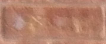

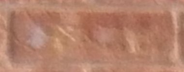

Topic came up a while back. To my mind they should both have the same result.
These were taken and then one brick (475' away) cropped from the result.
This one is using the digital zoom
And this one is without the digital zoom
The cropping isn't exact, but the length of the brick is pretty much the same.
I can't see any difference that makes one preferable to the other.
