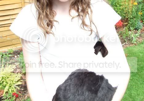

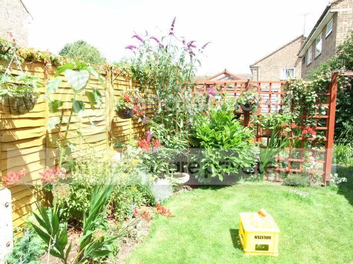

OK these photos were both taken this morning (so you know it's not super bright midday sun on the equator etc.)
If I remember rightly, the settings were on auto
When taking a photo, the image apears to look OK on the LCD screen or viewfinder but then looks way too bright when the photo is actually taken.
Do you think the camera itself could be at fault?

They definitely look overexposed. It is impossible to see why without the exif though. How did you resize them? I think some programs remove the exif when resizing. If you have changed settings and are not sure what you have done there is an option in the setup menu to reset everything to default.
