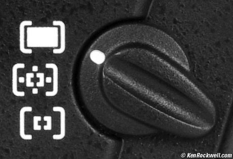

What I do (not always) is flick between focus modes for free kicks or corners, the image below is the focus switch on the Nikons, I flick from bottom to middle sometimes but never really change anything other than that, never really felt the need to
